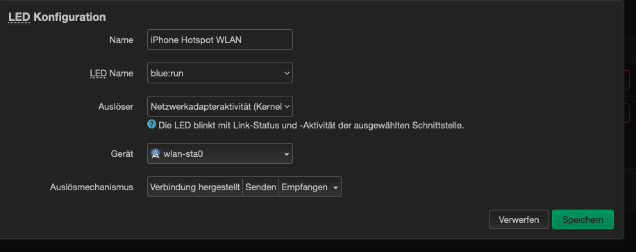

Problem 3, LED Setup, the storage remains only in the FW. “Beta 3 4.1.0“ Receive?

The pictures were taken for a better understanding, the errors are described there including the firmware.
