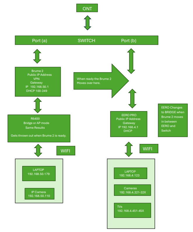

We have an ONT going to a switch where the networks diverge, one for the Brume 2 with test devices and one for the “brand X” router with all of our LAN.
I was concerned that the device IP addresses will change forcing a reconfiguration. Given I am blowing this out on a separate line I will be forced to load them all up if/when I move this router into the regular network we use.
Yes, the R6400 is in AP mode and the devices are all in the Brume’s subnet. I moved that router over to this network from the other where it was only serving as the NAS with a USB drive. Brand X (DHCP and VPN) drove an Eero Pro (in bridge) which handled the LAN. Everything in the condo except one TV was associated with the Eero and addressable with host.domain over its VPN.

Could you please draw a network topology—including IP addresses and device roles (such as the VPN server and the sub-router running in AP mode)—so that we can better understand your scenario?

Ok Wil, hopefully this adequately illustrates the topology. There really is not much to it. Right now this is how things are configured so I can test the VPN etc.. The ports on the switch get unique public IP addresses which sets up the environment quickly and easily. The topology hung off port (a) will go away when the Brume 2 is ready and I am comfortable with it.

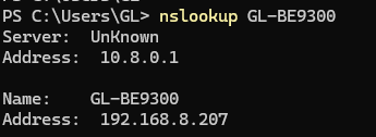

In your application scenario, we believe that you only need to enable “Allow Remote Access LAN on Server” and set the VPN client’s DNS to the router’s VPN IP.
The former allows VPN client devices to access LAN devices behind the router, while the latter allows DNS requests to be sent to the router so it can handle local domain name resolution.
The step of configuring Host in the tutorial is unnecessary. That step is intended for devices that cannot properly handle local domain names (do not support mDNS or do not advertise their hostname via DHCP).
For WireGuard, you had already configured it correctly before:
Enable “Allow Remote Access LAN on Server”
Change the DNS in the WireGuard client profile to the router’s VPN address only
For OpenVPN, you can perform similar operations:
In the exported .ovpn file, add a configuration specifying the DNS server as the router’s VPN IP:
# On OpenVPN 2.6
dns server 1 address 10.8.0.1
# obsolete on OpenVPN 2.6
dhcp-option DNS 10.8.0.1
