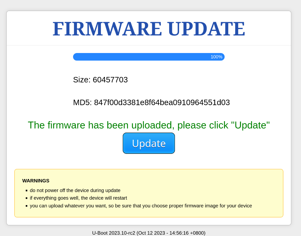

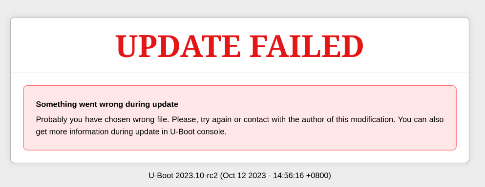

Next, I forced it to recovery mode and tried loading openwrt-mt6000-4.7.7-0415-1744685993.bin firmware through web :
Firmware update
Failed update
uart log
U-Boot 2023.10-rc2 (Oct 12 2023 - 14:56:16 +0800)
CPU:   MediaTek MT7986
Model: mt7986-rfb
DRAM:  1 GiB
Core:  34 devices, 19 uclasses, devicetree: embed
MMC:   mmc@11230000: 0
Loading Environment from MMC... OK
In:    serial@11002000
Out:   serial@11002000
Err:   serial@11002000
Net:   eth0: ethernet@15100000
RESET button is pressed for:  5 second(s)
Web failsafe UI started
T T T T T T T T T T GET /
GET /style.css
GET /index.js
GET /version
T T T T T T T T T T T T T T T T T T T T T POST /upload
    Content-Length: 60457965
T T T T T T T T T T T GET /flashing.html
GET /index.js
T GET /version
GET /result
GET /undefined
*** Partition 'kernel' not found! ***
*** Please update GPT first! ***
*** Partition 'rootfs' not found! ***
GET /fail.html
GET /style.css
GET /index.js
GET /version
T T T T T T T T T T T T T T T T T T T T T T T T T T T T T T T T T T T T T T T T T T T T T T T T T T T T T T T T GET /
GET /style.css
GET /index.js
GET /version
T T T T T T T T T T
It seems that the art partition probably was destroyed.
We will try to provide the uboot file and art file, but let me know the Device MAC (from bottom sticker) first.
