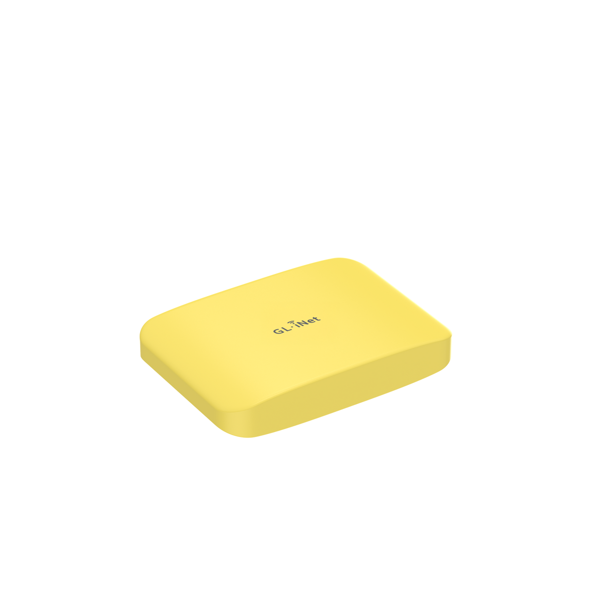

I’ve been using the Mango MT300N-V2 as my travel router for quite some time. It’s great, but the lack of 5GHz Wi-Fi is becoming increasingly noticeable. Has anyone managed to connect this router to a USB Wi-Fi adapter? How did the process go? From my research, it seems best to use an adapter with the MT7610U chipset, such as the TP-Link T2U v1. I apologize if this topic has already been covered, but I couldn't find anything. Has anyone tested it with a different chipset—perhaps one based on the MT7628?
