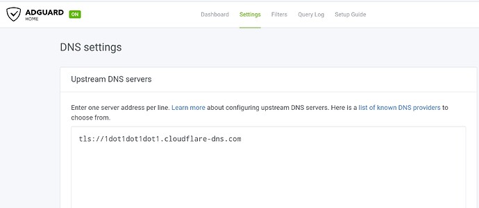

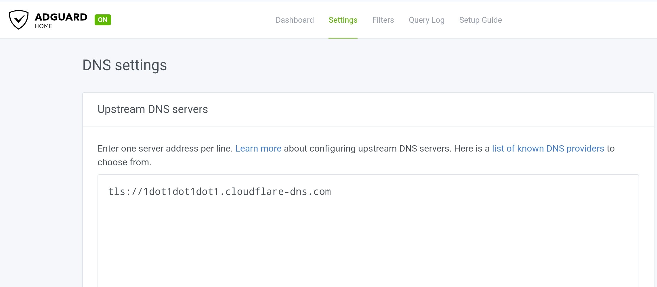

Im quite new to Adguard so I need a little bit of help. If I need to use DoH or DoT, do I still need to use certificates? I don’t have plans to access it remotely.

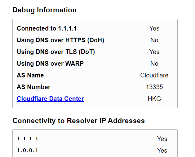

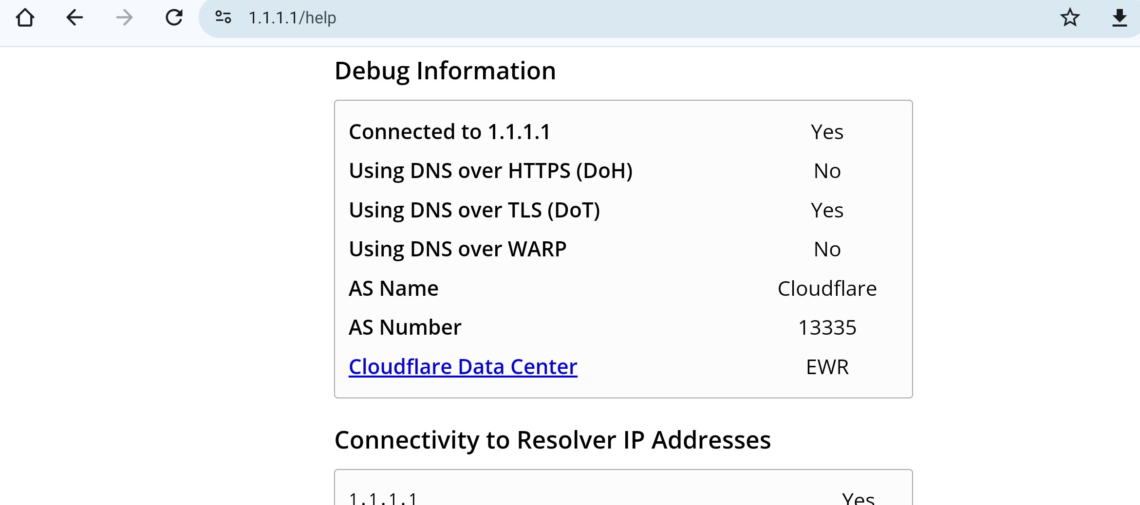

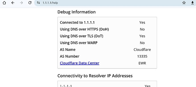

I just need a simple DoH or DoT and nothing else. I also copied your upstream DNS server and tested it using 1.1.1.1 and I’ve got the same results as yours.
Its already working and I only need to use proper DNS upstream, right? I’ve also read something about this on Reddit and I just want to double check if my understanding was correct.
If AGH is on your LAN, and you won’t access it remotely (eg via VPN) then you only really need to worry about the upstream.

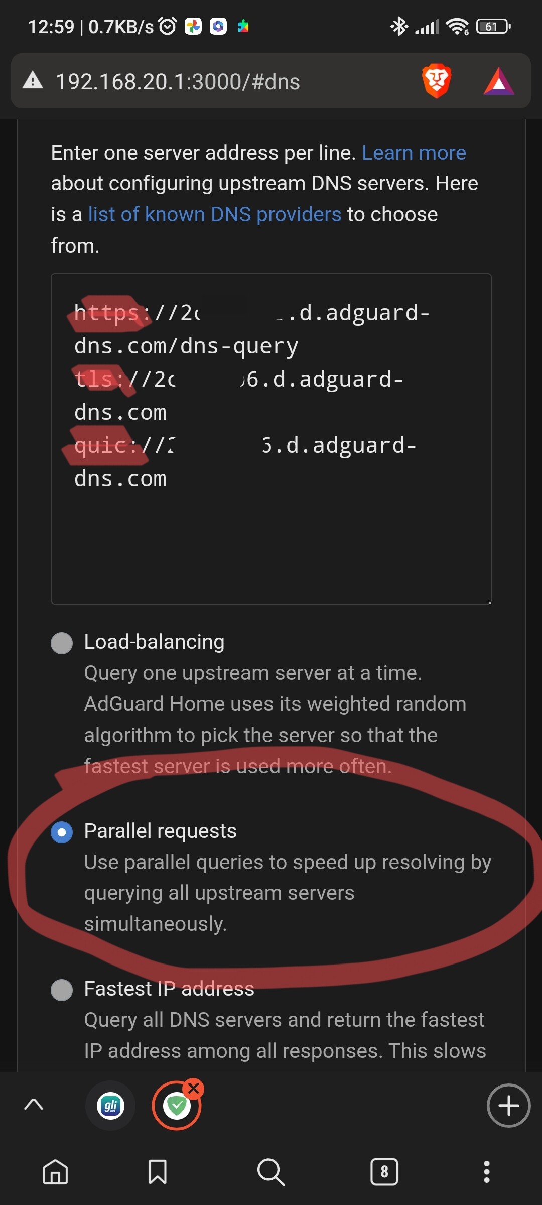

You could add few list upstream and Adguard home will auto best ping to connect dns servers.
For example I have 3 list:

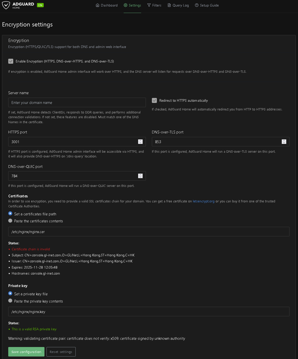

About Encrypt setting you can use local certificate if you want :wink:

You need them if you want to use encrypted DNS between your device, the router and the DNS upstream.
If you don’t care about unencrypted in your own network (most people don’t care about it) you can just keep it turned off. DNS over TLS is fine.

There are certificates in the router itself you could use for encryption. These are the paths for the configuration (attached pictures) That’s how I am using them.

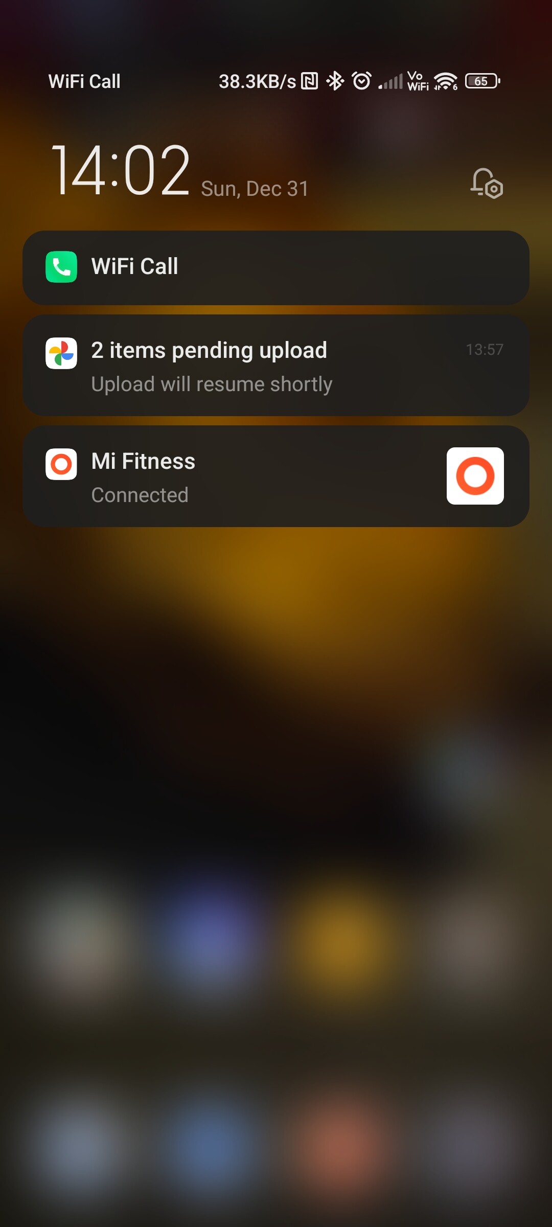

This router does mean voip? WiFi calls or VoWiFi
no it means your SIM provider it allow WiFi call
no special requirement on router side
