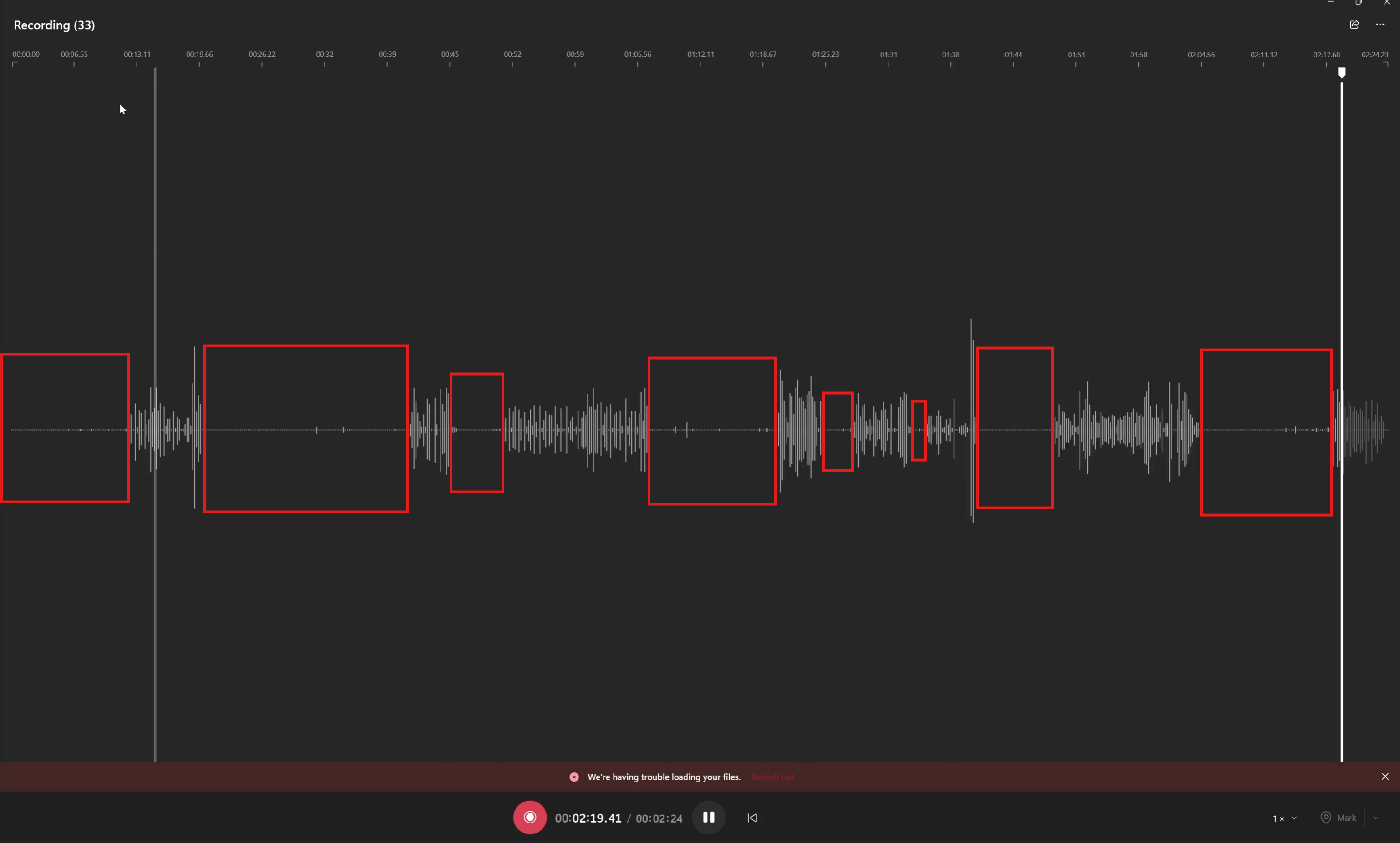

I am testing microphone on local network and I have noticed that there are several-second interruptions in the microphone.
I have tested this on both built-in microphone and external microphone.
Also I have noticed that no matter what mic I use there is always few seconds delay until the mic starts recording. Also when i take a break from talking and resume it also takes few seconds for microphone do start working.
Here is a voice recording. On red I highlighted all mic interruptions:
The issue does not occur when I directly connect microphones to remote machine.
