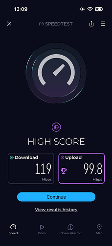

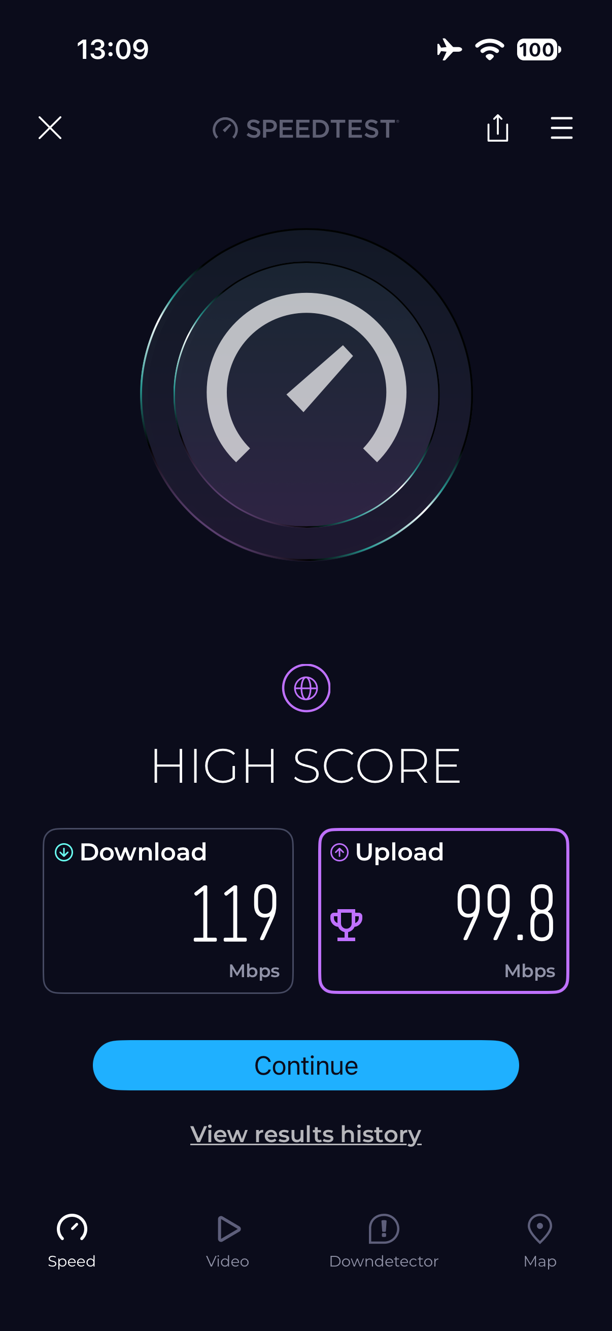

Here is Speedtest running direct from client running WireGuard client to same endpoint connected directly to hotel WiFi rather than the Beryl ax
so this eliminates the hotel WiFi as being the limitation for WireGuard
