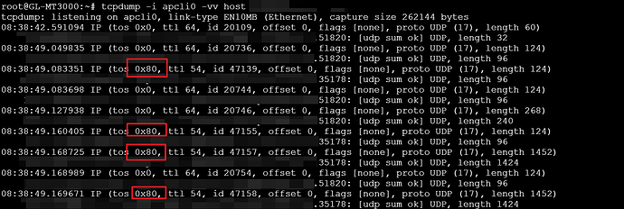

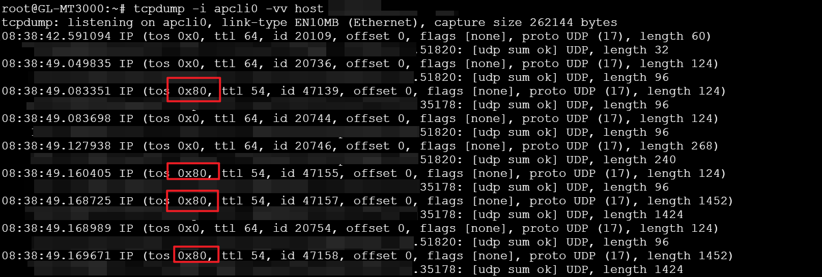

After analyzing the packet captures, we found that the downstream WireGuard traffic coming from the upstream Wi-Fi network is marked with DSCP 0x80 / CS4.
In comparison, normal iPerf3 traffic and SpeedTest downstream traffic going directly through the WAN interface are marked with the DSCP 0x00 / CS0.
Therefore, we suspect that the hotel Wi-Fi may start identifying WireGuard traffic after some time and rate-limit it by applying a specific DSCP marking.

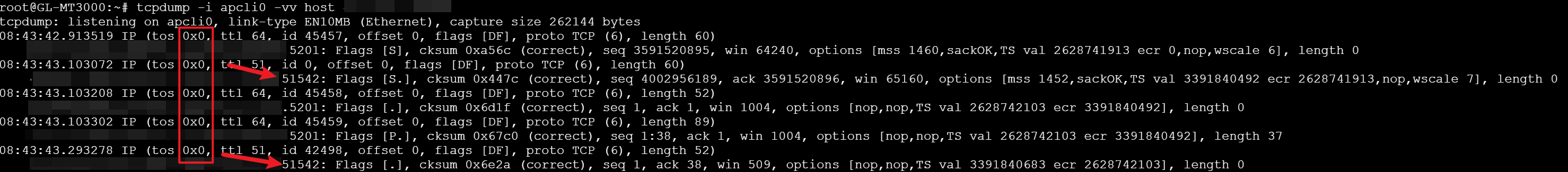

Hi I switched and switched back, throughout successfully returned. Managed to ssh in to router using termius, tcpdump starts listening but then never returns query on 2.4ghz
On 5ghz it returns the traffic, largely all 0x0 and some 0x2
Because the hotel uplink is currently using 5 GHz, seeing no matching packets on apcli0 (the 2.4 GHz interface) is expected. On apclix0, 0x02 means DSCP 0 / CS0 with the two low bits used for ECN; it is not the earlier CS4 marking. Thus, the current capture is largely normal and provides a useful comparison with the 0x80 / CS4 marking observed while throughput was limited.
Please keep the capture available for @will.qiu. If the slowdown returns before departure, capturing the same traffic without first switching networks would provide the direct before/after comparison.
