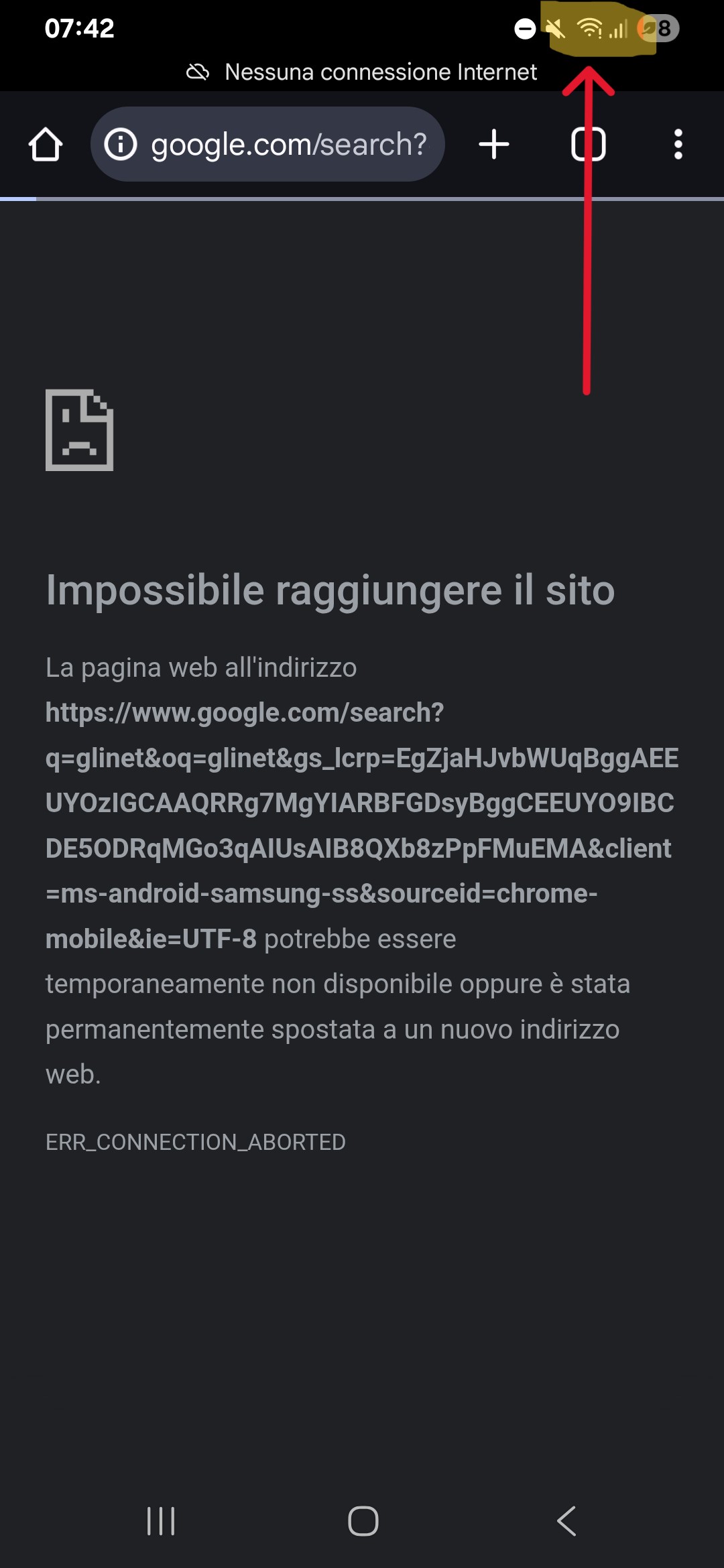

I’d like to report some strange behavior with my MT3000 router after a recent upgrade. I performed a fresh installation, no configuration was kept, everything was set up from scratch.
:small_blue_diamond: **Issue #1 After a blackout, when power returns, the router boots up normally. However, DNS seems to fail: I can access the internet and ping any address, but Google Search doesn’t work (other search engines do). A simple reboot via the web GUI resolves this issue.
:small_blue_diamond: **Issue #2 After that reboot, my VPN client tunnels stop working. I use two WireGuard clients and one OpenVPN client. I have to manually toggle them off and on to restore functionality.

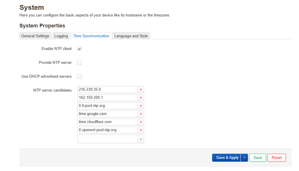

If you use DOH/DOT &/or the kill switch with the VPN connections you're going to have trouble syncing time to NTP as there's no RTC in these devices. The TLS/authentication handshakes won't work properly until then.
Adding NTP IPs will be faster than waiting for a DNS response.
	uci -q batch <<- __EOF
	set system.@timeserver[0].server='0.openwrt.pool.ntp.org 1.openwrt.pool.ntp.org 2.openwrt.pool.ntp.org 3.openwrt.pool.ntp.org 104.167.241.197 73.239.145.47 142.147.88.111 171.66.97.126'
	set system.@timeserver[0].use_dhcp='0'
__EOF
	uci commit system
That's my best guess ATM.

Thanks for your help. I modified the NTP configuration through LuCI and tested the solution by unplugging the router. Now the VPN is working fine, but Google DNS resolution is still not functioning. Any ideas?

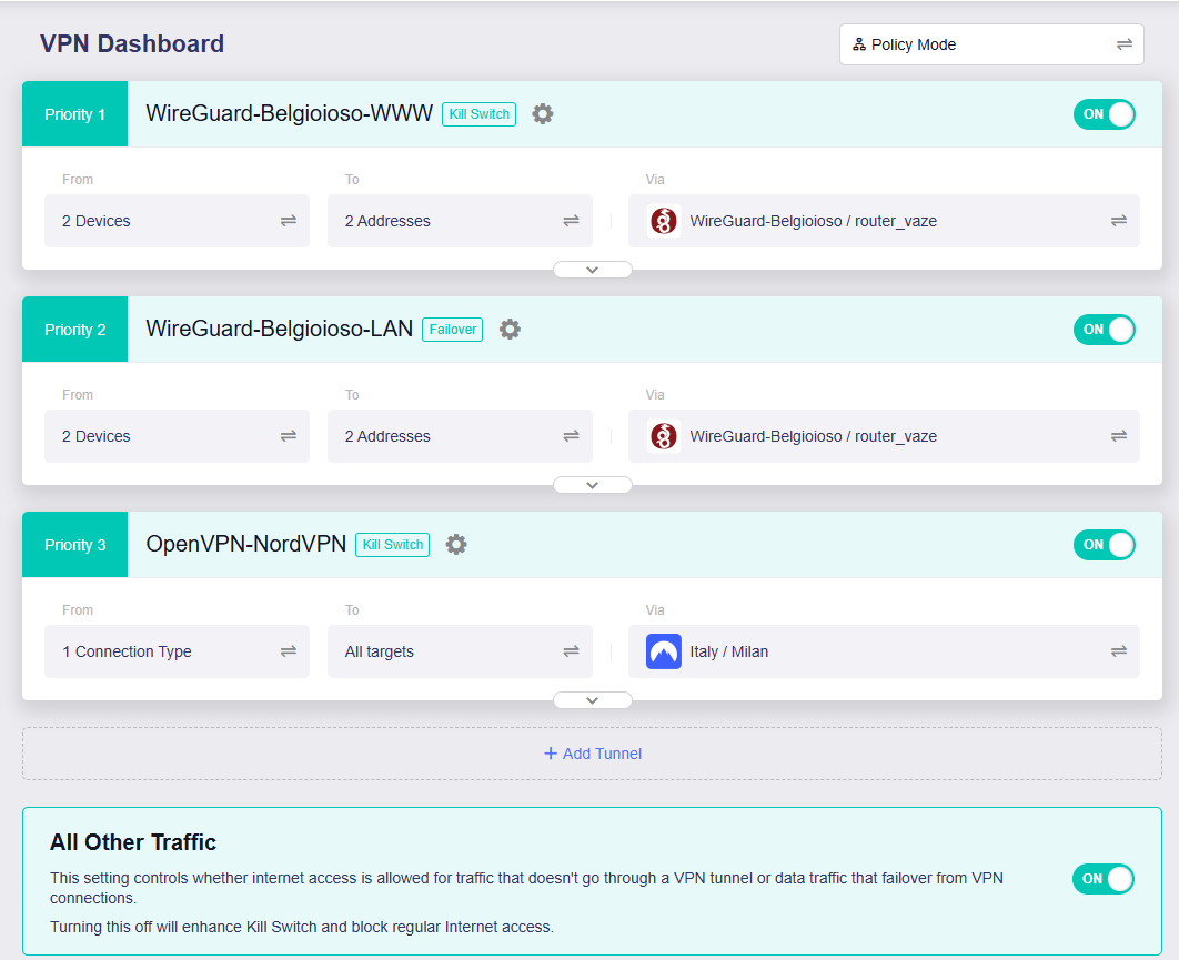

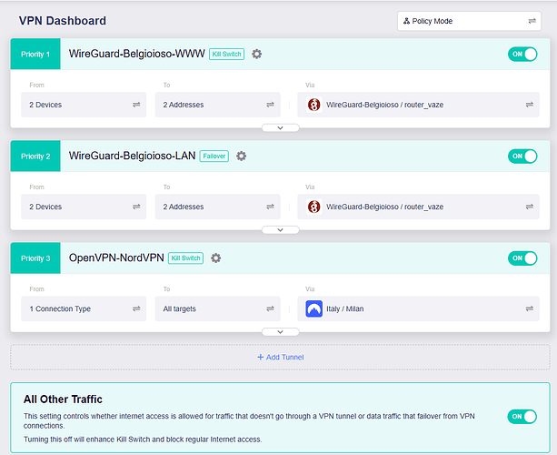

Please screenshot the VPN Dashboard.

root@GL-MT3000:~# ping 8.8.8.8
PING 8.8.8.8 (8.8.8.8): 56 data bytes
64 bytes from 8.8.8.8: seq=0 ttl=116 time=7.993 ms
bytes from 8.8.8.8: seq=1 ttl=116 time=7.856 ms
^C
--- 8.8.8.8 ping statistics ---
2 packets transmitted, 2 packets received, 0% packet loss
round-trip min/avg/max = 7.856/7.924/7.993 ms
root@GL-MT3000:~# ping www.google.com
PING www.google.com (216.58.205.36): 56 data bytes
64 bytes from 216.58.205.36: seq=0 ttl=115 time=8.673 ms
^C
--- www.google.com ping statistics ---
1 packets transmitted, 1 packets received, 0% packet loss
round-trip min/avg/max = 8.673/8.673/8.673 ms

Thanks for your patience! I finally had the chance to connect to my router locally and apply the changes you suggested. First, I updated the firmware to version 4.8.1. Then I configured DoH using the DNS you recommended (Quad9).
Everything is working perfectly now! I even simulated a power outage to test the setup, and the router resumed operation smoothly after power was restored.

Engage WG, full/all kill switches & DOT. Set just NTP DNS. Reboot & let me know what happens.
