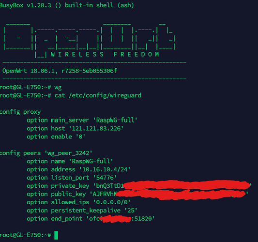

upon executing wg0 in ssh … result is empty
please assist

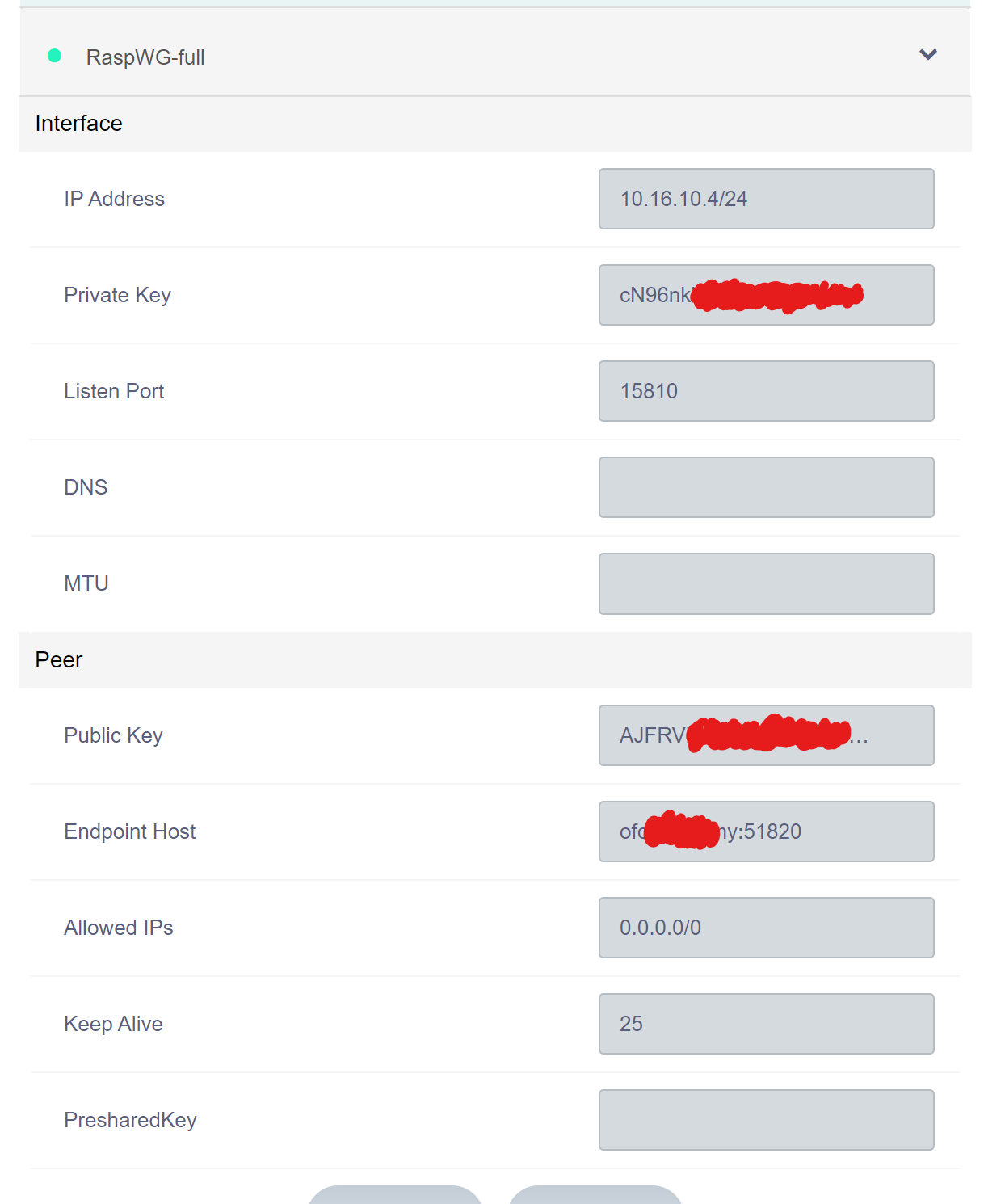

Yes created a unique account for mudi e750 after testing other accounts with my iOS and Android.

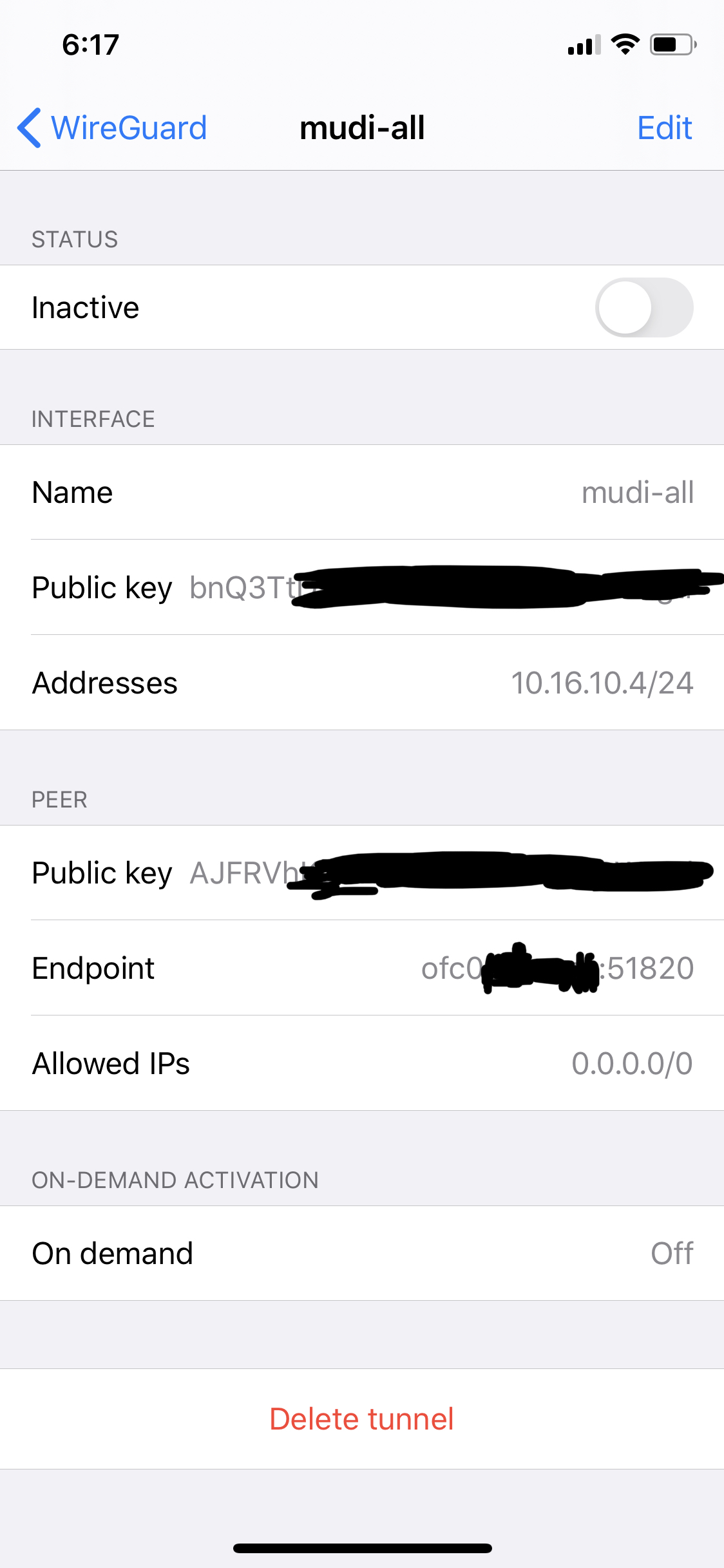

But as I was having problem connecting the mudi as WG client, I replicate the credentials to my iOS which works fine too. Please refer to attached

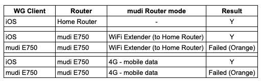

hi rp201rp,
appreciate your continued assistance; please refer to attached multiple test case results.

From your screenshot, you can see that without the enable configuration, you can ssh to the routing background, then modify the enable to 1, and then execute /etc/init.d/wireguard start in the background.
If there is still a problem, please /etc/config/wireguard, /etc/config/firewall and /etc/init.d/wireguard send me a copy of the file, and use the logread command to send me the output information

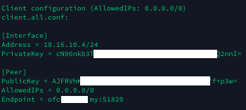

you are showing your wg client config for the mudi.
can you post the client config from ios. android wg client has an export function not sure if ios has one. of course block keys and endpoint
@jsiahpc
Hi , I used the configuration you sent, and the wireguard client connection using my android phone was also unreachable, and it was not able to connect on the router. You can use the configuration you sent me, and try with your android or ios device I guess there is a problem with the configuration, is it the wrong key?

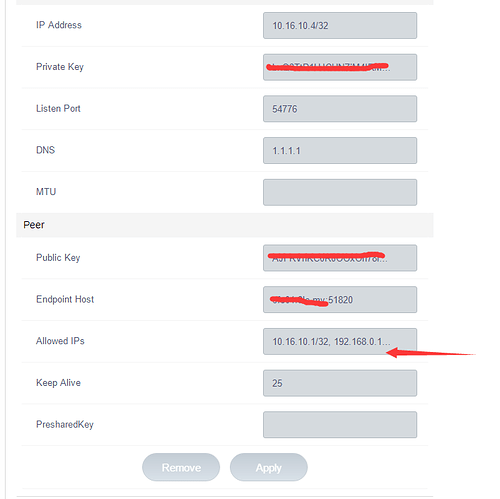

Hi, i re-created a new entry in Mudi E750 with setting provided with WG server on Raspberry and this time it works (see attached screenshot for future reference) but only for “AllowedIPs = 0.0.0.0/0” and NOT "AllowedIPs = 10.16.10.1/32, 192.168.0.1/16
Same behaviour for Android and iOS, where i get bad tunnel address error when AllowedIPs set to internal/private only.
[update #1] On iOS even on full route, a DNS entry is required.
[update #2] for trial & error, on iOS for split … setting the WG server IP (in my case 10.16.10.1) as DNS seems to work but not for mudi E750 or Android.

My WG server config running on Raspberry.
RaspWG-client-config

You can modify AllowedIPs as follows:
Yes i did, and it does connect but only able to access those private IPs range; no internet at all.
Also, when manually creating WG client in mudi e750, it does not allow input of 2 subnet during creation but you may add on on existing profile under Management page

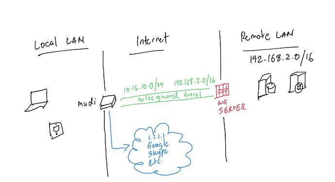

hi gl, thanks you helping out yesterday. what i am trying to achieve is per attached.
appreciate your assistance once again.
