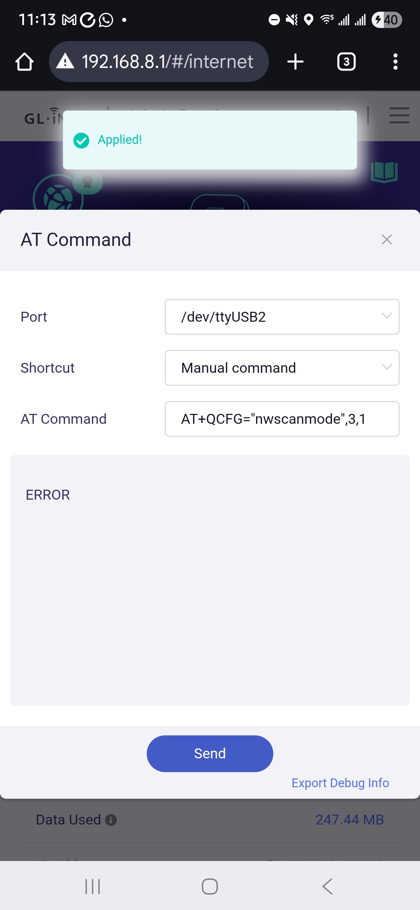

Command show Error
AT+QCFG="nwscanmode",3,1
