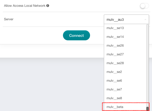

I had to reinstall ar750s, and it loads a bit, then fails.
It only loads configs until a _beta …?
Bildschirmfoto 2022-04-09 um 17.00.59
Pls try firmware 3.212 beta3.
It pull all the server from Mullvad around 1 minute.
