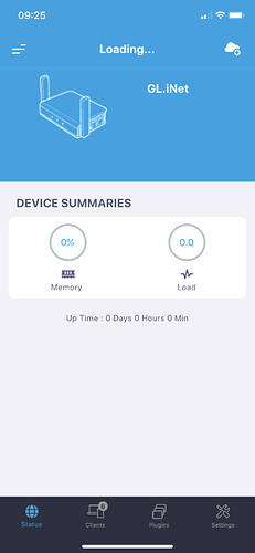

In the gl.inet iOS app it says 67% memory 0.19 load yesterday memory was 16% is 67% not too high?
My setup is wireguard client, killswitch, Vpn policy and adguard Home with standard dns filter
I hope the killswitch, vpn policy don’t crash when memory reach 100%

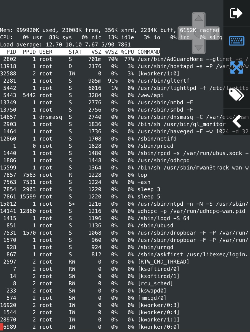

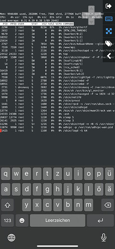

You can also ssh to the router and check which processes are using the memory using “top”
It’s now 97%
VSZ Is how much memory is available for the process, not how much is being used. You want to look for RSS - Resident Set Size.
As Alfie wrote before, linux will try to allocate all ram to all processes, to improve performance, as ram is already reserved and ready to go. This does not mean the program is using all that ram.

Seems there is memory leak from this figure.
Again reached 99 or 100% couldn’t connect with gl inet app or with browser to router GUI
After restart memory was 15% again and everything worked
We are checking to find out where is the memory leak.
