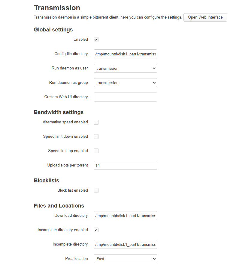

Transmission creates settings files of its own when you configure it and you will see it on your drive unless you use default folder that is in Config File Directory setting/option.
In transmission settings; What did you put in to "Config File Directory"??
Don't use "incomplete directory", there is no point. Tell transmission to only use: "Download Directory". In Download Directory you will use full pass to your external HD that you copied from Mount Points/Global settings: tmp/mountd/disk1_part1
If you want Transmission to download files in to a folder "hello", you need to use tmp/mountd/disk1_part1/hello in Download Directory setting.
Do me a favor and post screen shots of your Luci settings and Transmission settings. I think we are missing something.

as for the config folder i told it to point to /tmp/mountd/disk1_part1/transmission
ok ill get some screen shots
  1. Config File Directory is where Transmission app settings will be saved. When you access the Hard Drive on your computer, you will see folder “transmission”, inside that folder you will see various folder and files created by Transmission app.
  2. Disable Incomplete Directory, you don’t need it.
  3. Complete Directory. Give it another pass. /tmp/mountd/disk1_part1 this is the main root partition of the external hard drive. If you use /tmp/mountd/disk1_part1/hello , it will create folder “hello” on the hard drive. This where torrents will be downloaded.

here is the screen shot this is using the orico enclosure so it re mounts each reboot.. i did enable the network storage share so thats how i rename the .added to just ,torrent and then it re loads it into transmission but then reboot and they are gone.. i thinking cuz its saving it all temporary? in ram and not really saving it to the SSD cuz its all under /tmp is my guess?
Did you disable incomplete folder in transmission settings.

Looking at the screen shot, everything looks as it should. Your external HDD/SSD is /tmp/mountd/disk1_part1. Its equivalent to C: drive on a computer.
Next to it, did you click on edit blue icon and enable R/W permissions??
