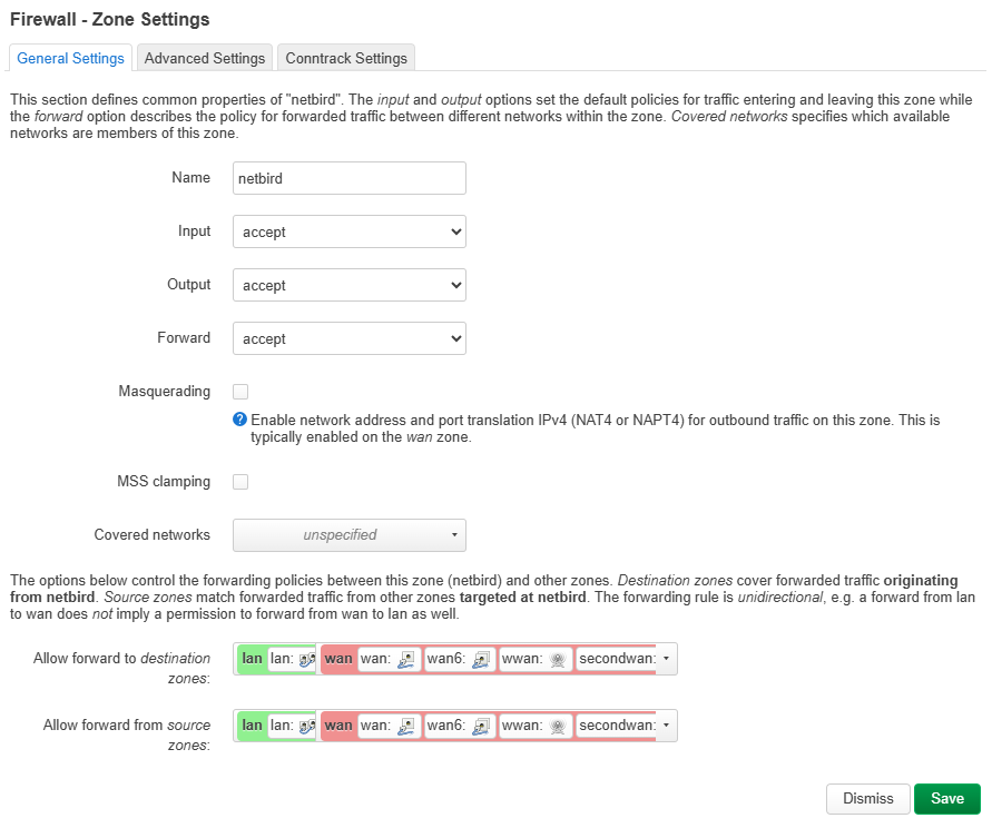

I assume you have installed netbird in GL router and login your account with the key, and added an exit node in network route 0.0.0.0/0 in the netbird console, and advertise to the group including to the GL router Slate7.
Please add this rule in Luci -> Network -> Firewall to allow netbird to forward to br-lan and wan zone:

Hi Bruce,
Thats perfect its now up and running as expected. I can access all netbird nodes and also traffic from the Slate 7 is being forwarded via the netbird exit node when i have it enabled.
I had already added a Network in my Netbird account for the Local network of the Slate, but I had not added the additional firewall rule via the Luci interface as you mentioned. Once I added these everything works perfectly.

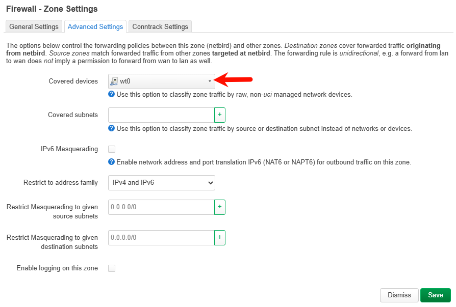

  6. Access the Luci Advanced interface,
    i) Access menu Network > Firewall , then add a new Firewall zone called netbird and setting Input, Output and Forward to Accept. Enabling masqerade, then allow forwarding to and from the netbird zone from the lan firewall zone.
    ii) Access menu Network > Interfaces , then create a new Interface called netbird and assign the wt0 device to the interface and add the Interface to the netbird firewall zone.
I was then able to connect to the Slate 7 Peer over my Netbird network. Additionally, if I enable an Exit Node on my netbird network all the devices on the Slate 7 LAN are then able to route their internet traffic via the designated Exit node.
