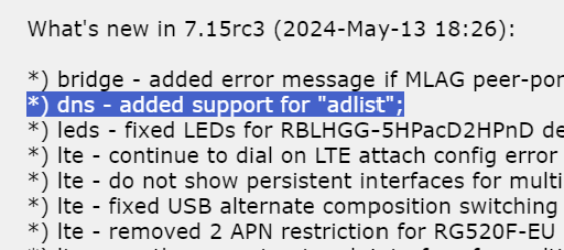

It would be nice if GL.iNet had some kind of inbuilt adlist function like Mikrotik have just added to RouterOS 7.15
https://help.mikrotik.com/docs/display/ROS/DNS
