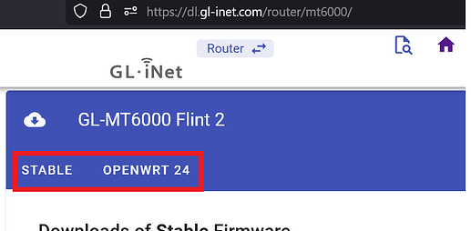

Is there any reason for the Beta and Snapshots were been removed?
Eddited: I guess it's because the 4.6.2 was moved to the Stable now.
Can you point me to the new build for berly ax please. There is nothing new in the download center.
@thomasm 4.6.2 is available in software center. It is dated 6-28-2024. This is the latest stable version.

Not for my router, apparently the S1300 is very low priority.
I mean the Native OpenWrt 24 version. Not the stable one.
@thomasm Ah, ok, so unrelated to the 4.6 versions in this thread.
I don't know much about that model, but it shows as discontinued on the gl-inet website. Generally devices fall into maintenance updates and may not get feature updates. Thus, I would not hold my breath for anything in the 4.x branch or newer.
