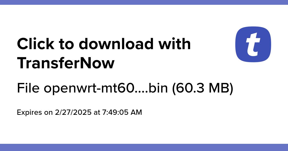

Thanks for your response. Steps were: 1) clean RC firmware install on the Flint 2 and using PPPoE for internet access. 2) Turning wireguard client (using windscribe) working ok. 3) turning encrypted DNS on using my NextDNS profile without changing any other settings is where the problem starts and I am unable to access any website at all. 4) Either turning VPN client off or switching DNS back to automatic restores my internet connection. 5) Keeping VPN on and activating Adguard and internet is still working. 6) Reverting back to earlier firmware version and I am not experiencing the same issue.
Here you go:
Thank you! We'll use the steps you provided to reproduce it, btw confirming that the previous firmware version was 4.7.0? GL.iNet download center
