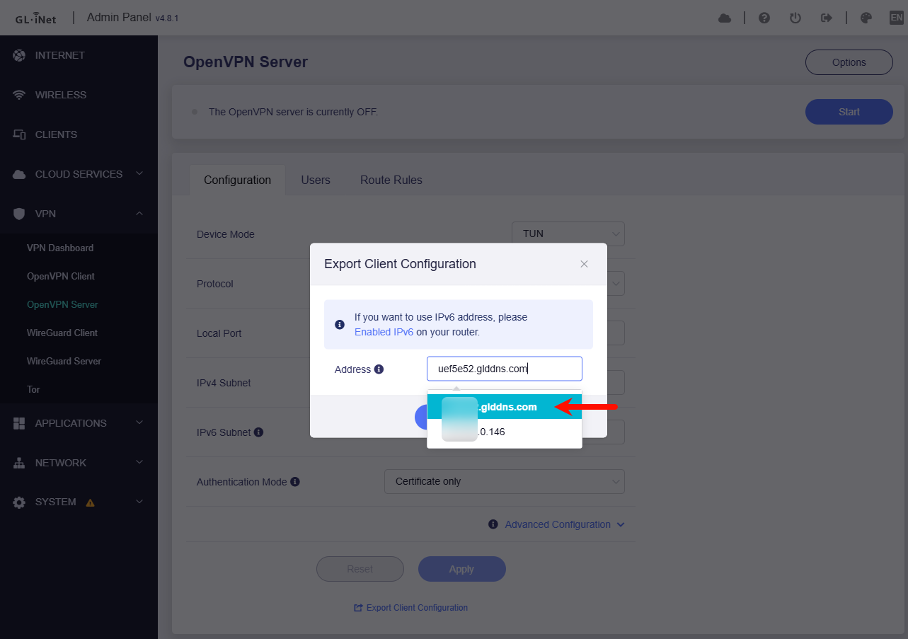

:face_with_peeking_eye: OMG, it’s hidden now. So we now need to click on the address window to see the popup with the DDNS hostname now. OK. :upside_down_face:
