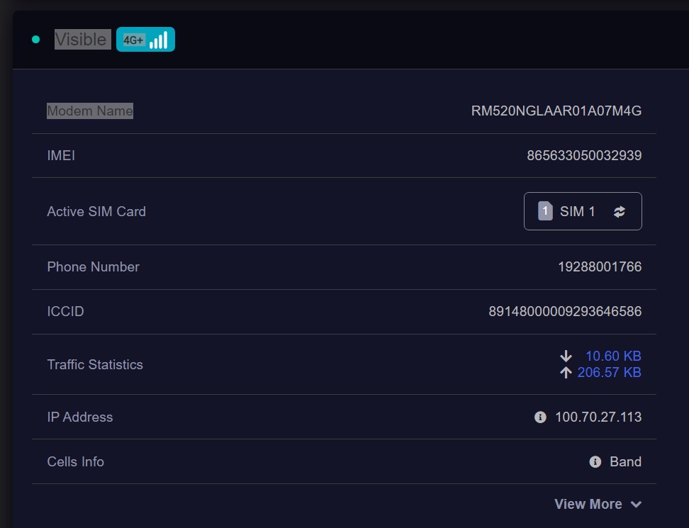

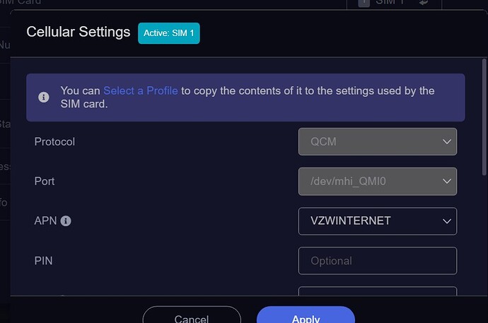

New issue w GL-X3000 Spitz AX not staying connected
seems to connect, shows blue color on
but the icon on top goes white
Screenshot 2024-02-17 193510
tried “internet” and VZWINTERNET for APN, both connect but soon go white icon above, the first pic stays blue??
need ideas or help to fix, this was working great, was rock solid, before i upgrade to recent firmware…
Thanks
Mike

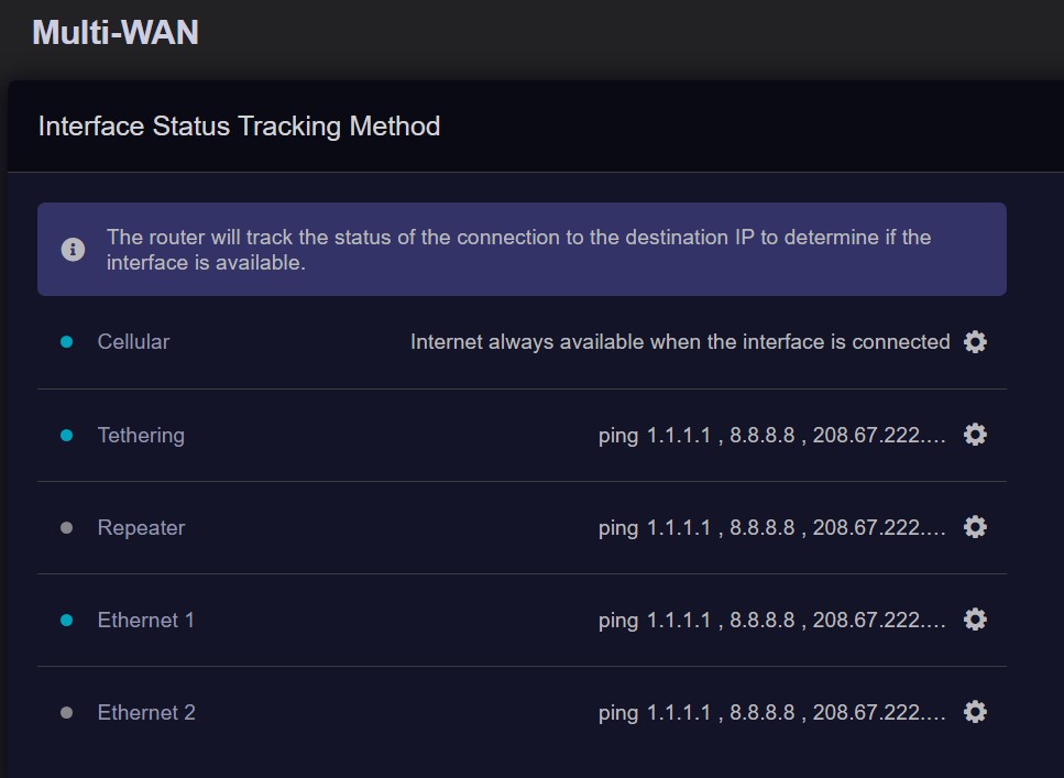

Update… I turned off Interface status tracking on cellular(see below)
Now the cellular icon stays blue and connected??
Screenshot 2024-02-17 201826
Thoughts??
Yes the tracking feature is indeed very buggy! I always turn it off after establishing the connection.

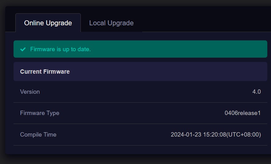

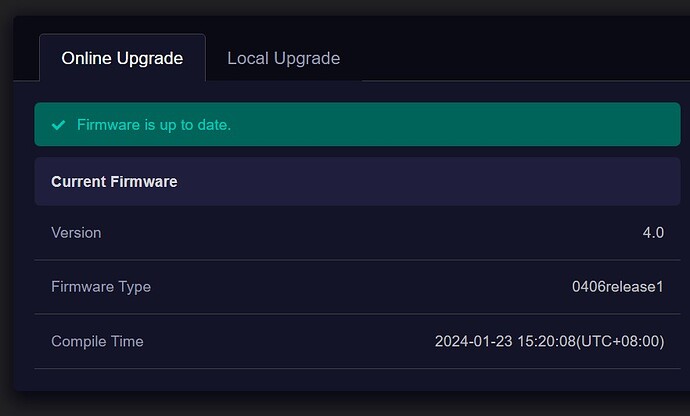

This issue has been fixed in Version: 4.5 and is awaiting update for release.
Seems to be similar to the issue I have: GL-X3000 - Cellular connection issue - #52 by makkie
Can’t wait for the new firmware release … maybe a beta release is available earlier?

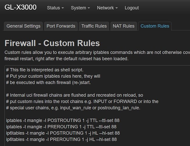

I use custom firewall rules, do we lose this in 4.5 version??
4.5.7 here, the Custom rules panel still exists.
Hi, I’ve the same problem, when is the new firmware going to be released? Thanks
How can i turn off the tracking? Thanks
From the Multi-wan tab.
Thanks a lot, but this has not solved the random disconnection problem.
Hi Summer,
Many thanks :slight_smile: . Just wondering if we have an ETA for the 4.5 release? Fingers crossed
root@GL-X3000:~# ps | grep 'track\|check_ip'
24738 root      1456 S    /bin/sh /usr/sbin/mwan3track modem_0001 rmnet_mhi0 online 10.43.53.41 1.1.1.1
25637 root      1448 S    /bin/ash -c sleep 30;. /lib/functions/modem.sh;check_ip
26762 root      1448 S    /bin/ash -c sleep 30;. /lib/functions/modem.sh;check_ip
26806 root      1396 R    grep track\|check_ip
You can see the processes that cause the issue above. Kill it after the establishment of the connection.
I have tried 30 secs and using 8.8.8.8 and 8.8.4.4 and seems to work ok in tether and repeater, will try for cell service connection
