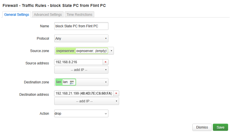

Now… As a first test so I could understand the Luci firewall traffic rule configuration, I was attempting to block traffic from 1 specific computer on the Slate LAN from reaching 1 specific computer on the Flint LAN.
I want other Slate LAN computers to still be able to reach the Flint LAN.
I want the specific computer on the Slate LAN to reach other computers on the Flint LAN.
The test is to block traffic originating from the Slate LAN PC 192.168.8.216 from reaching the Flint LAN PC at 192.168.21.199
On the Flint Luci Firewall settings I created a traffic rule.
But this does not stop pings from 192.168.8.216 to 192.168.21.199
I even moved the rule to the first position of the rules list.
I also stopped the VPN server on the Flint and the VPN client on the Slate. And restarted them.
Still no luck.
I’m missing something.
John
You can try installing tcpdump on the router to capture packets and see what’s happening.
opkg update && opkg install tcpdump
tcpdump -i any icmp and ip host 192.168.8.216
If you’ve already covered all the configurations, you should also disable the VPN client’s IP Masquerading feature on the Slate. Otherwise, the source IP of devices on the Slate LAN will be NATed to the VPN IP.
Since you didn’t specify the firmware version, this option should generally be found in the Admin Panel under VPN → VPN Dashboard.
