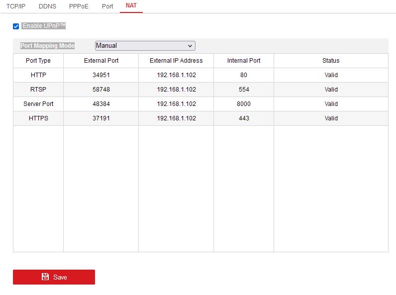

I have put a few screen shots of the DVR showing the ports needed, but when you have A VPN does that need to be selected on my original post I tried a 3 different combinations none worked I also tried with the VPN client disabled and also disable Block Non-VPN Traffic all works obviously but not the DVR, hope I’ve explained it enough.

Ok I fired up my old Billion router which has UPnP and this is what the DVR reported picture attached.
So port forwarding should show valid I would guess.
