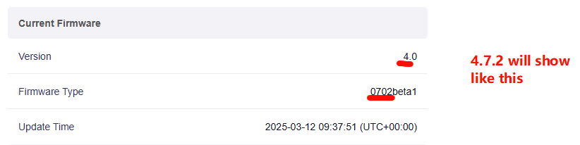

Hi, I've been having a problem with my Mudi v2 router for two months, with version 4.0. When I installed the common 4.7.2 version, I got a message that the update was successful, but it still showed version 4.0 in the settings. Why?

The version display for cellular routers differs from that of home/travel routers.
The version number shows the major version,
while the minor/bug fix version is displayed under the firmware type.
