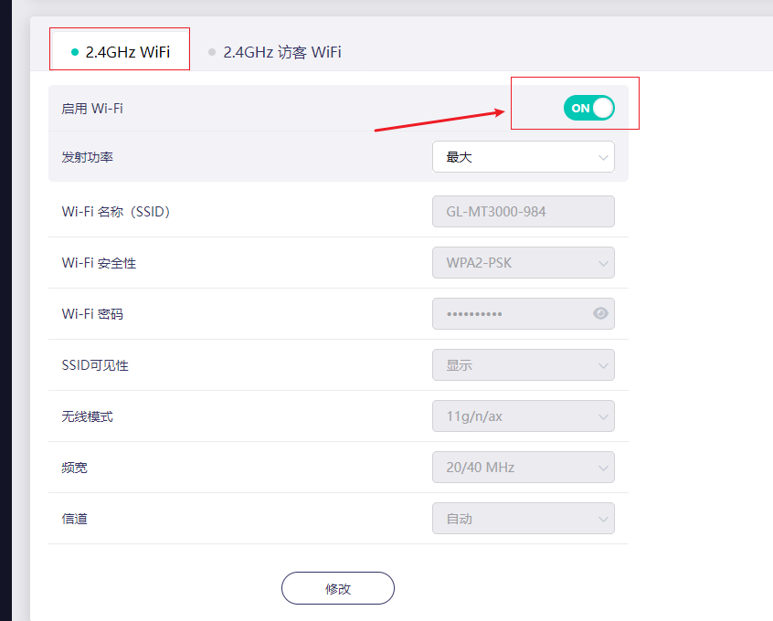

I finally found the solution. Everything started working as expected after I enabled this setting under Repeater Options in the main UI: “Allow Repeating Of DFS Channels”
Now the router finds both 2.4Ghz and 5Ghz channels and the repeater functionality works fine.
Reading the description of this setting, it’s not very clear to me why this setting is disabled by default as I’m guessing many others would run into this issue with WiFis that are using these channels. Maybe someone from the gl.inet staff can comment to give more information.
The firmware version 4.5 has been changed to enable it by default.
Initially this was due to the channel availability scan that occurs when repeating a DFS channel, which interrupts WiFi.

Hi, cemhamami
The current situation is that the 2.4Ghz and 5Ghz channels can be scanned and showed in wifi list but can`t be connected? The log shows that the connection to 2.4g failed!
Before enabling the DFS setting, some networks were missing from the WiFi list and attempts to connect to any network that do show up was failing in this way. After enabling the DFS setting, all 2.4Ghz and 5Ghz show up in the list as expected now. However, I’m still having trouble connecting to some networks often, in this case I picked a 2.4Ghz from the list but the connection failed.
This is anecdotal but so far the 5Ghz ones seem to be succeeding and I haven’t had any luck connecting to 2.4Ghz ones, if that provides any clue.
I just tried with a WiFi at a different location and the 2.4Ghz one still failed to connect while the 5.8Ghz one succeeded, so I think it’s very likely that something related to 2.4Ghz is the issue.
Is 2.4G wifi enabled?
Yes the 2.4G wifi is enabled.
Hi cemhamami,
I tried to reproduce the problem, but it didn’t happen locally. Can you export the configuration on the luci page and send it to me?
Hey @cjc
I had the 2.4Ghz channel disabled during normal usage but only had turned it on before enabling the repeater mode, and in this scenario it wasn’t working. However, after rebooting the device with the 2.4Ghz enabled, the 2.4Ghz network also started working as expected for repeater mode.
I’ll mark the DFS channel toggle as the accepter answer, but just a note that there may be a bug with needing to reboot the device for repeater mode if the 2.4Ghz has been recently enabled.
