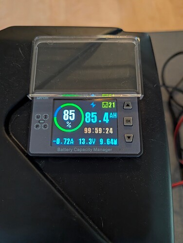

I just hooked my X3000 up to a 12V LiFePO4 battery box which has a battery meter and shunt connected to it. At idle the X3000 draws ~4 watts and during a speed test with a WireGuard VPN running it averaged ~9 watts with a peak at 9.64. I do not have any devices connected to the USB port. I am using this cable to connect the X3000 to my battery. Amazon.com

I'm seeing about the same numbers on my X3000. Days when i'm not around and the router is the only thing running I see about 60-70 Wh usage per day
