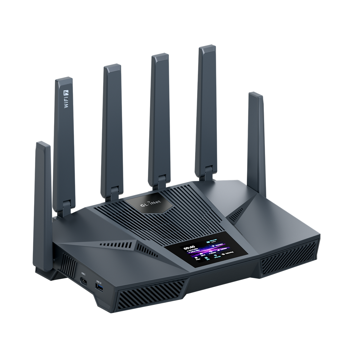

At present, we do not have an officially released router that can directly replace the ISP fiber box on its own. However, you may consider our upcoming Flint 4, which will be equipped with an SFP+ port.
However, to connect the router directly to your fiber line, you would still need to purchase an SFP ONU module with ONT functionality separately.
Flint 4 has not been officially released yet. You can subscribe for product updates on our official website.
In the meantime, we recommend asking your ISP whether the existing fiber box can be configured in bridge mode, and then using your current Flint as the main router.
This allows the ISP device to continue handling the fiber connection while Flint manages your home network.
