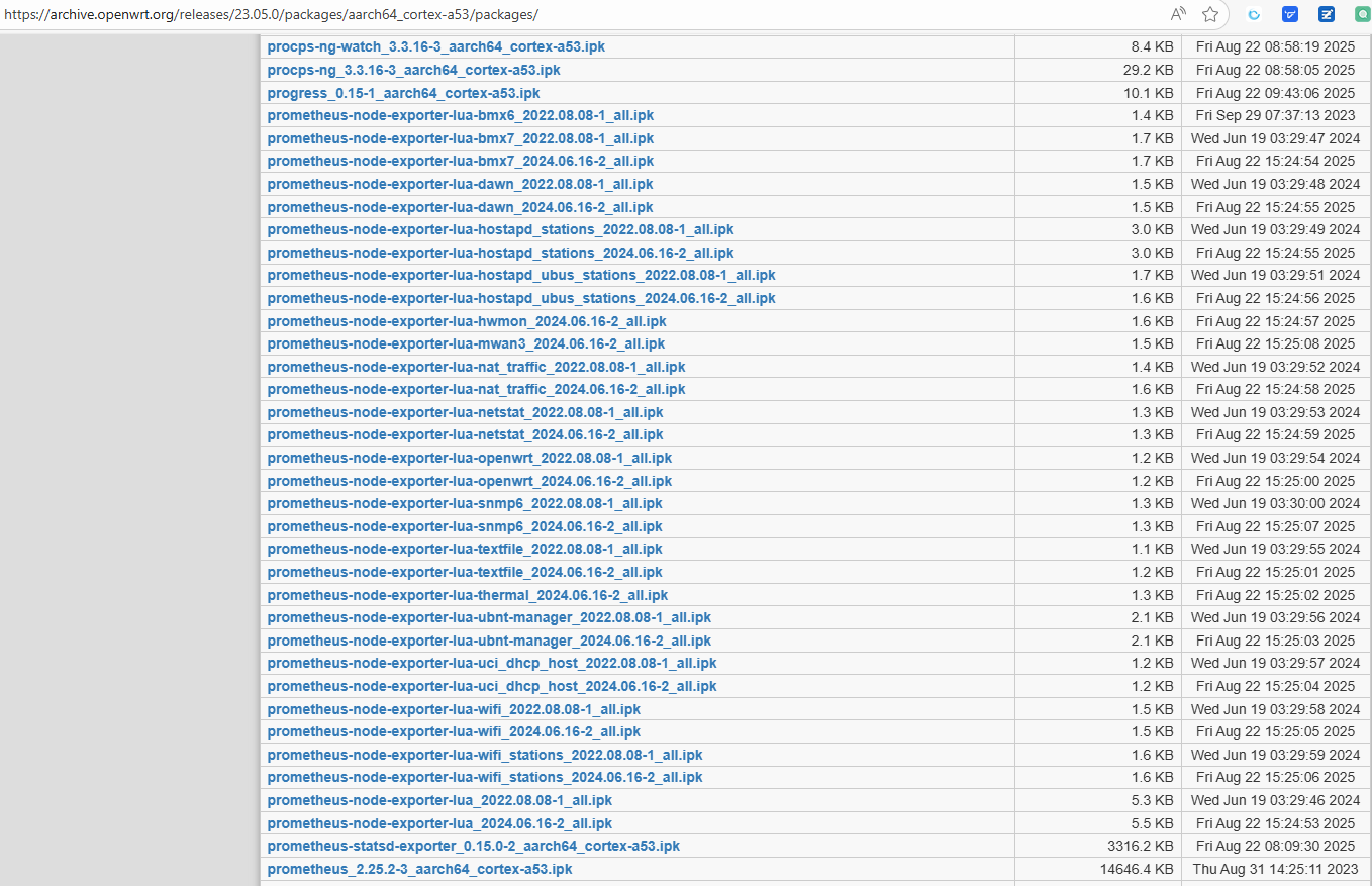

I note that the prometheus-node packages in the on the older v23 optware gl-net software repo for the BE3600 are dates from 2024 v6.16 however the packages for the MT3000 on the new v24 are all from 2025 v7.15.
If I post a separate requests can your team update the version of the Prometheus-node packages for the be3600 repos to the same as the mt3000 v24 repo?
