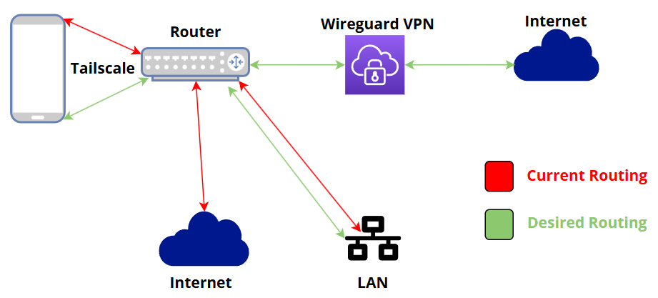

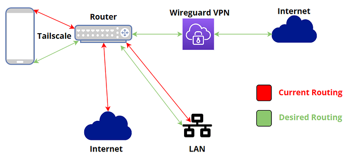

I have Tailscale on my Flint3 router so I can connect my phone to my home network when I’m out. This works well for using Jellyfin, Symphonium, Immich and for accessing my files and routing my internet traffic through my home connection when I’m out.
However, I have a privacy VPN set up on my router to mask all the traffic that comes from my home network.
I want the Tailscale exit node traffic to be routed through the privacy VPN too, because I don’t want to expose the traffic that’s coming from my phone and going through my home internet connection.
So the route would basically be like this: Phone ==> Tailscale ==> Privacy VPN ===> Internet
Any help with this would be appreciated.

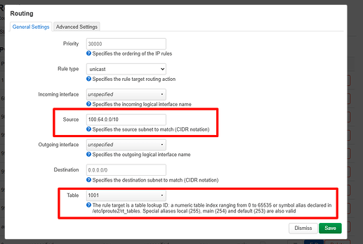

Here are the steps to further adjust the configuration to make with Tailscale exit node work with WireGuard VPN:

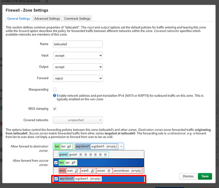

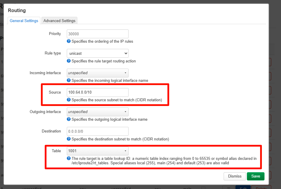

  1. In Luci - Network - Firewall - Zones, configure tailscale0 to allow forwarding to wgclient1.

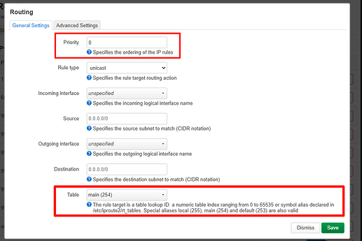

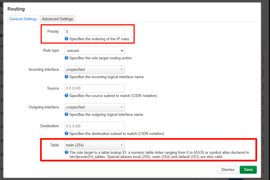

  2. In Luci - Network - Routing - IPv4 rules, add the following two rules:
    2.1 Forward outbound traffic from the Tailscale network into the VPN tunnel.

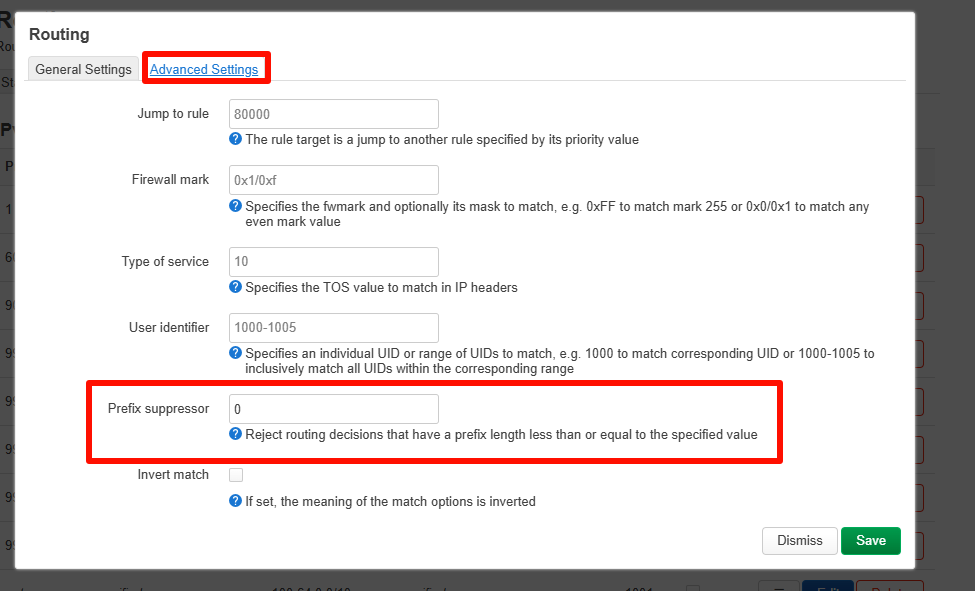

    2.2 Prevent form Tailscale to local LAN traffic that matches

This is what I’m trying to achieve. It’s the internet (WAN) routing I’m finding difficult. As I’m pretty inexperienced with this, I’d need step by step explanations with no ambiguity or assumption of prior knowledge. For information, I’m using Surfshark as the VPN, and used the Gl.inet UI to configure that as the wireguard VPN. Thanks in advance.
Also in relation to the reply. I wasn’t sure where to find the subnet CIDR value. But I managed to find it in the status page of LuCI. That was the main issue. I was trying all kinds of addresses in there to see if that was the problem. So if anyone else comes across this. You can find the subnet CIDR notation on the menu under status and then routing.

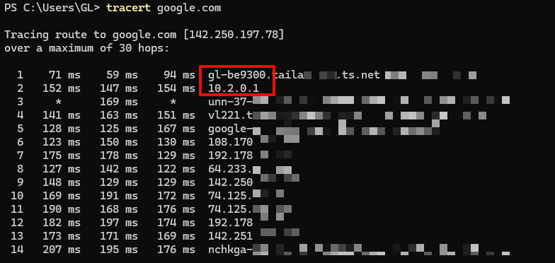

We tested it locally and it is still functioning normally on BE9300 v4.8.3.

Has the routing options moved? Can’t seem to find Luci - Network - Routing - IPv4 rules. The only thing I can find close is Static IPv4 Routes. There are missing pieces in this section.
Some models may not support configuring IP Rules in LuCI. As an alternative, you can SSH into the router and execute the following commands:
# 2.1
ip rule add from 100.64.0.0/10 pref 6000 table 1001
# 2.2
ip rule add priority 0 pref 0 suppress_prefixlength 0 table main
Afterward, you can add these commands to /etc/rc.local to ensure they are configured automatically upon startup.
