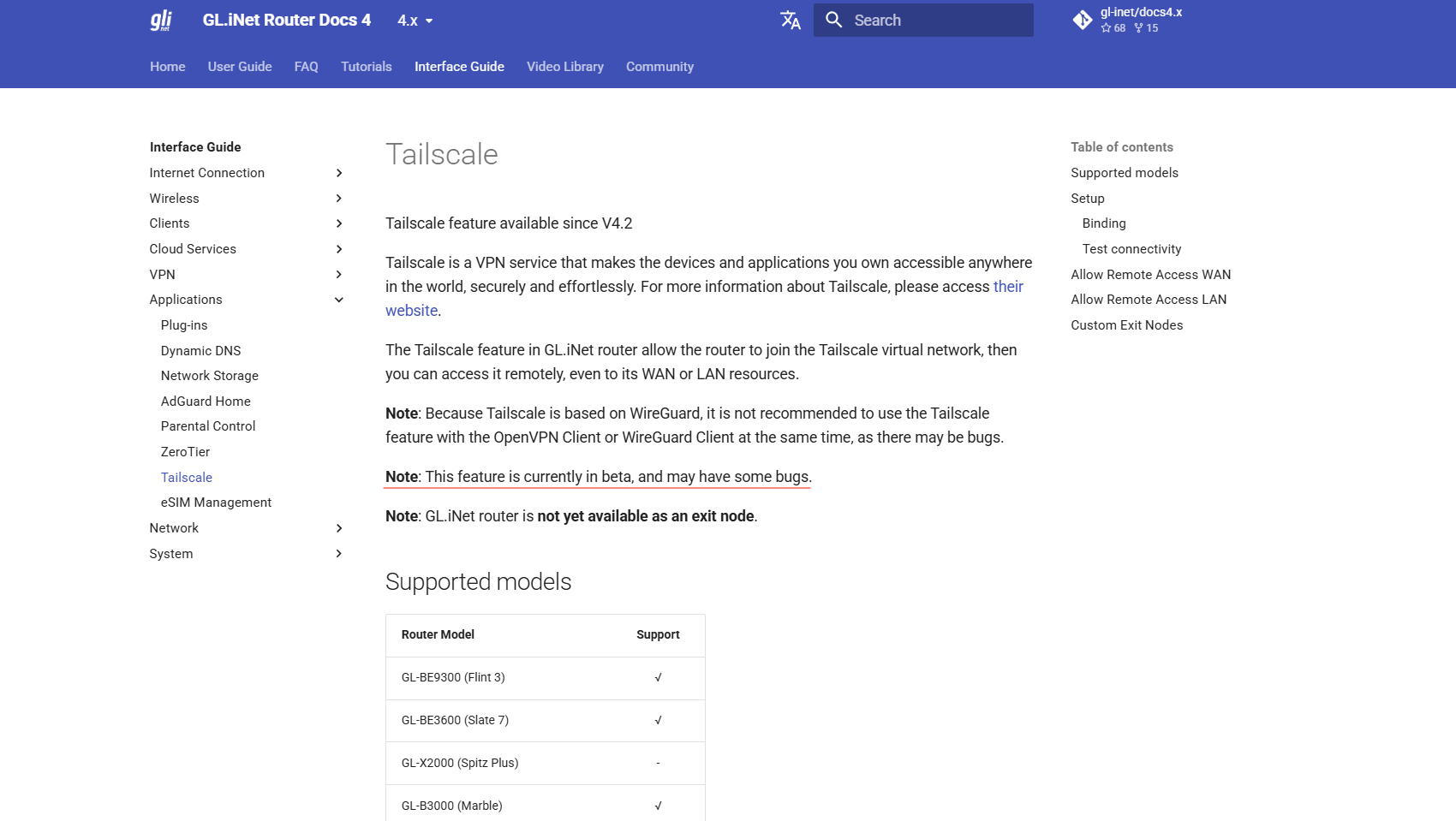

May I know are you asking why there is a "Beta" label in Tailscale?
Since the Tailscale of GL firmware only has some basic functions, and there may be some undiscovered bugs or incomplete functions on some models. So we label it as "Beta".
If it is just using basic functions, such as forming a virtual network "TailNet", it is available.
Here is what I was talking about:
Now I know Beta will be there anyways despite the version change.
