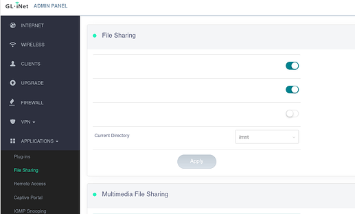

3: Here is what I am talking about. In the category File Sharing - I am guessing what slide switches I am enabling. Not sure why the text isn’t there.
Everything else is working for me and I already got my wireguard clients in and everything.
But if I wanted to fix this - what do I try next?
Thanks in advance

Regarding #3, I have seen and posted about the missing/blank labels on my router also, which is shown in the doc.
I do not work for and I do not have formal association with GL.iNet.
I see the problem in the UI. Yes it is a problem in some versions.
As we are upgrading all to 4.x we are not fixing the display error in File sharing.

Sorry that I missed the slider switch text was a know error. But thanks for confirming the switches work and it is just a superficial thing.
