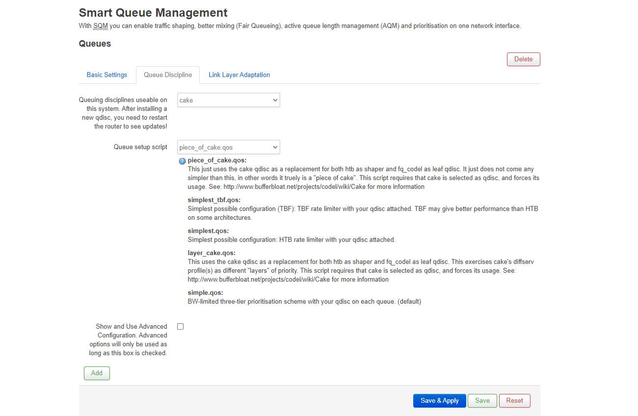

Your waveform results are way below what your SQM setting should be and there's something going on as the result should be indentical. When it's working correctly you will still have decent throughput and you wouldn't need to turn SQM off. Please set SQM back to default. Cake and piece of cake apply and reboot.

I have it set to 80mbps download since around 80 is where I get A+ bufferbloat on this little router
