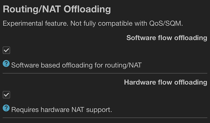

Did you disable hardware acceleration as well? Afaik disabling it is needed for SQM.
yes you need to disable hw acceleration, but probably also this (if it exist):
/etc/init.d/gl_qos stop && /etc/init.d/gl_qos disable
also on some routers sometimes cake isn't really playing nice then you want to prefer fq_codel, since it is using siflower soc I don't know which one plays out better.

Oh I’ve been wondering about the QOS thing since I don’t see the option anymore with the newest update. So do I have to disable it via SSH? I don’t see anywhere that lets me disable it thru the regular UI
It should also be via luci on system -> startup.
But i remember having this different namings.
I found it in firewall.
I disabled it and now SQM works without fluctuating the speeds
