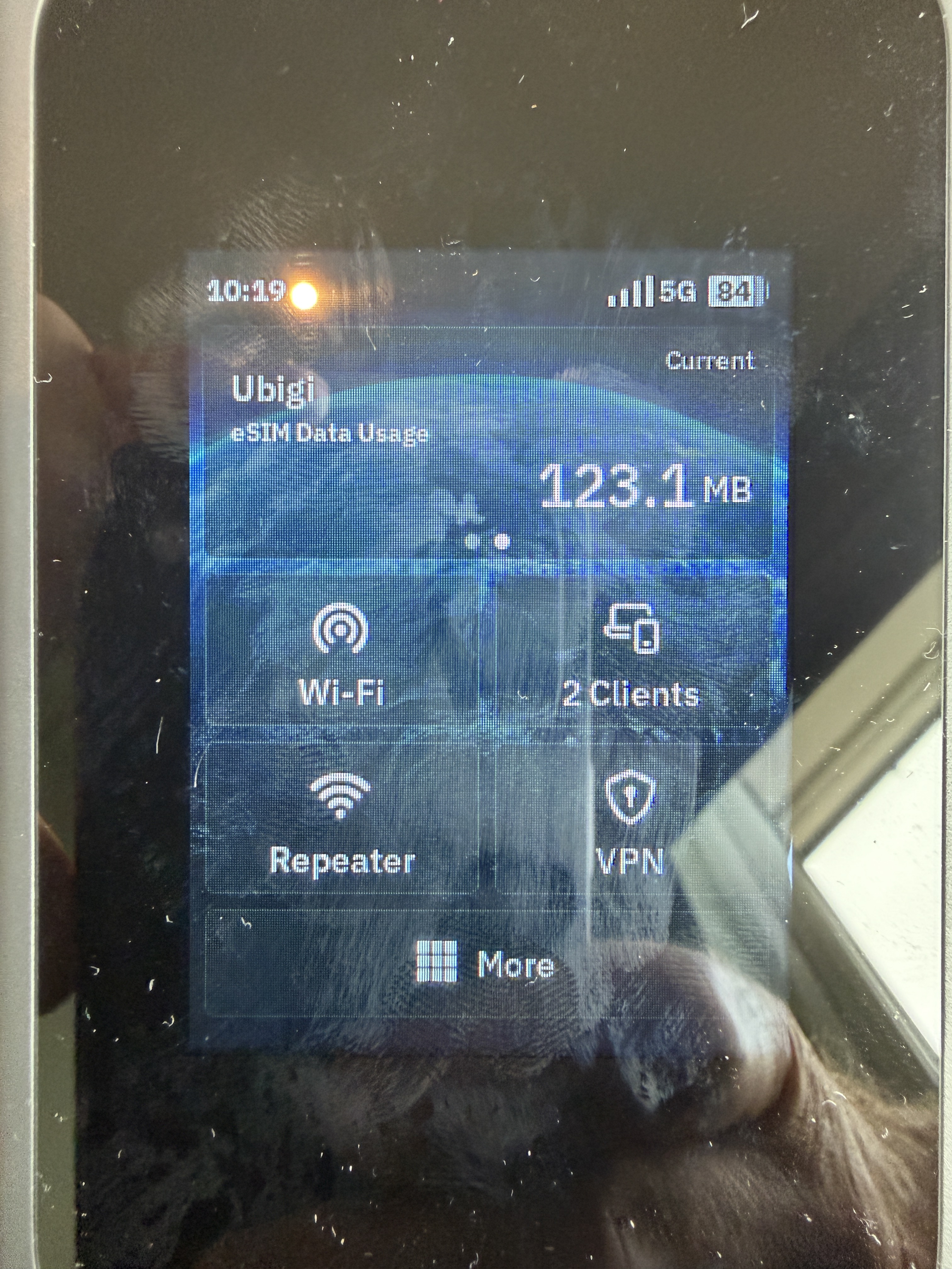

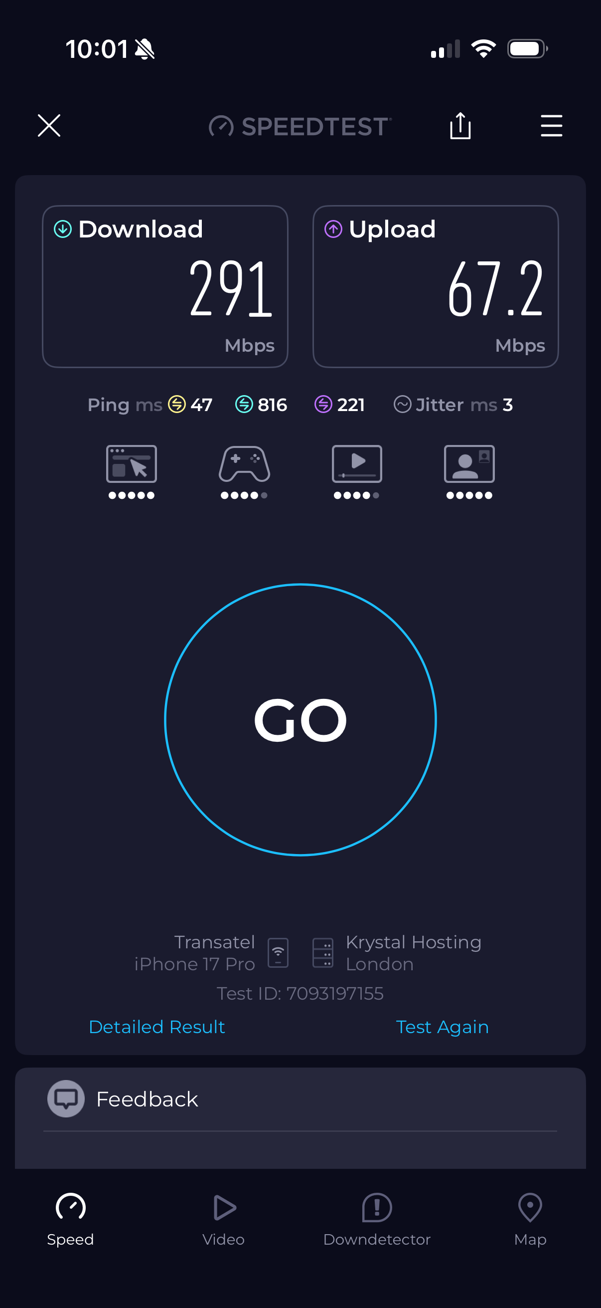

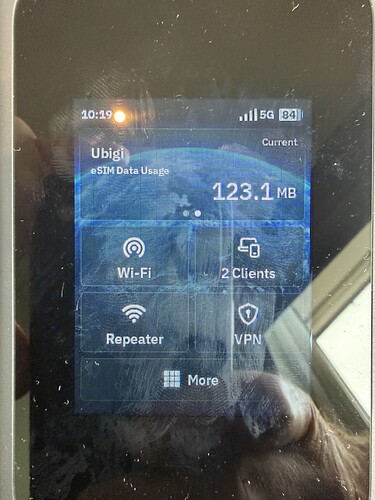

So, I’ve attached a couple of pics. One is of the Mudi screen, showing the Ubigi eSim connected and on 5G. The other is a speed test (Glasgow area this morning). My default sim is a physical Vodafone number, with Ubigi as my backup. When I first switch the unit on after it’s been idle for a while, it connects to Vodafone and initially shows the eSim as not registered.. However, when I switch to the eSim, it only takes 30 seconds or so to connect.

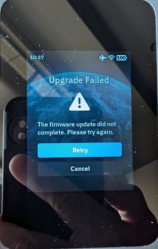

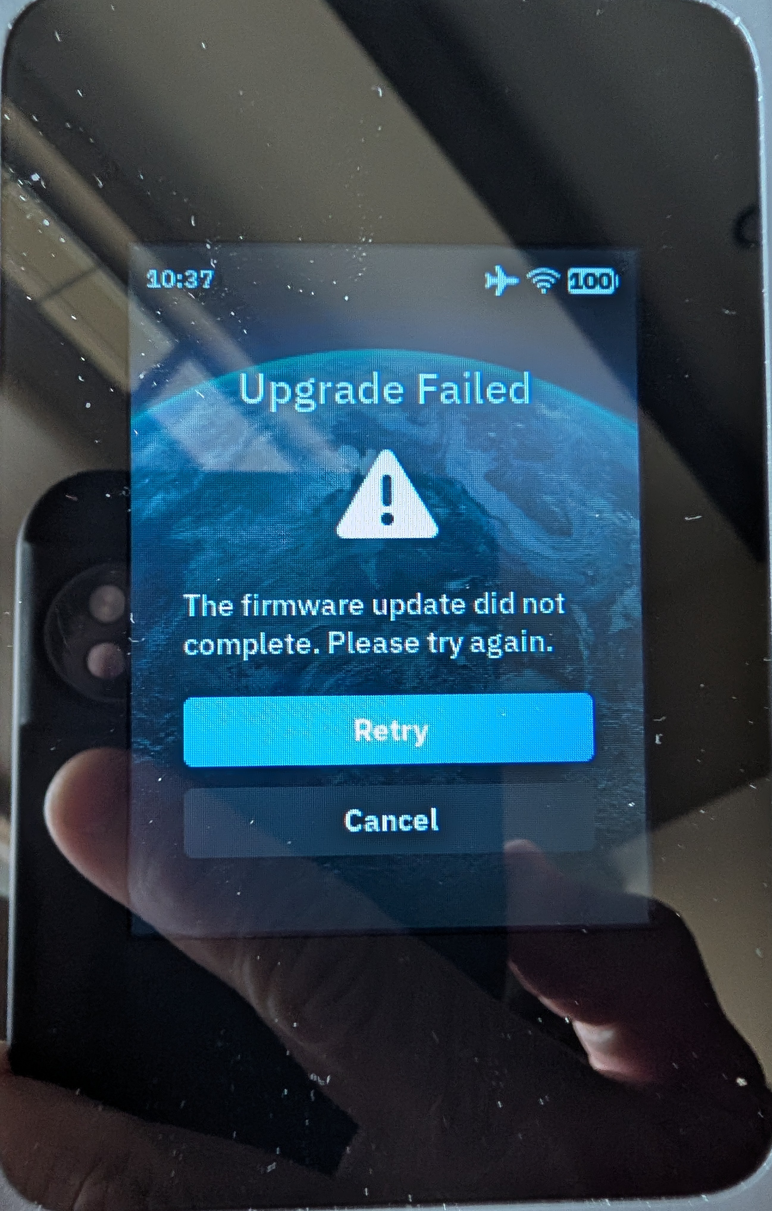

Update failed.

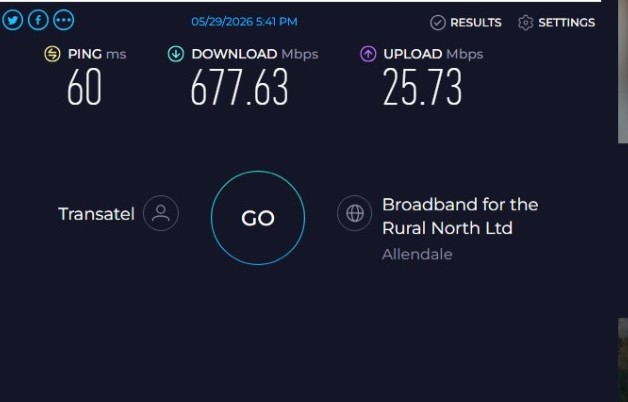

I haven’t used an external aerial, so the results are just from the internal one. Using it just now, and it’s happily streaming Prime Video. I’ve attached a screenshot showing download speeds of nearly 700Mb. That’s with full bars, and I haven’t tried it in a low signal area, but it gives you an idea of what it should be capable of. If you can’t get the same kind of result it does point to the unit.
