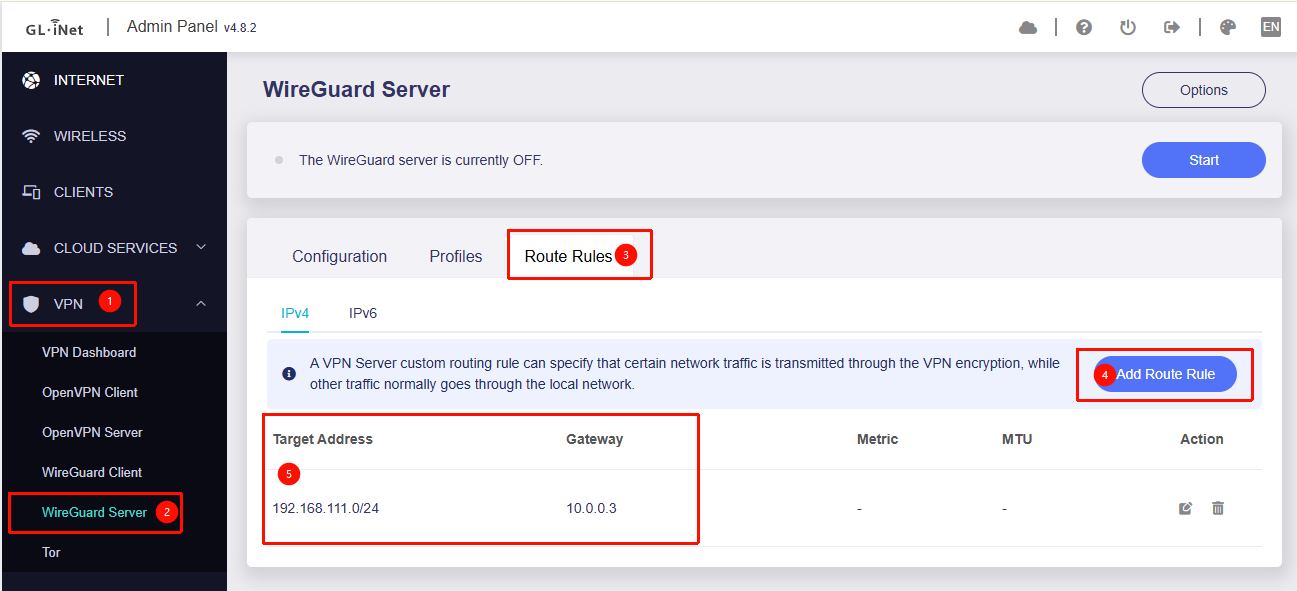

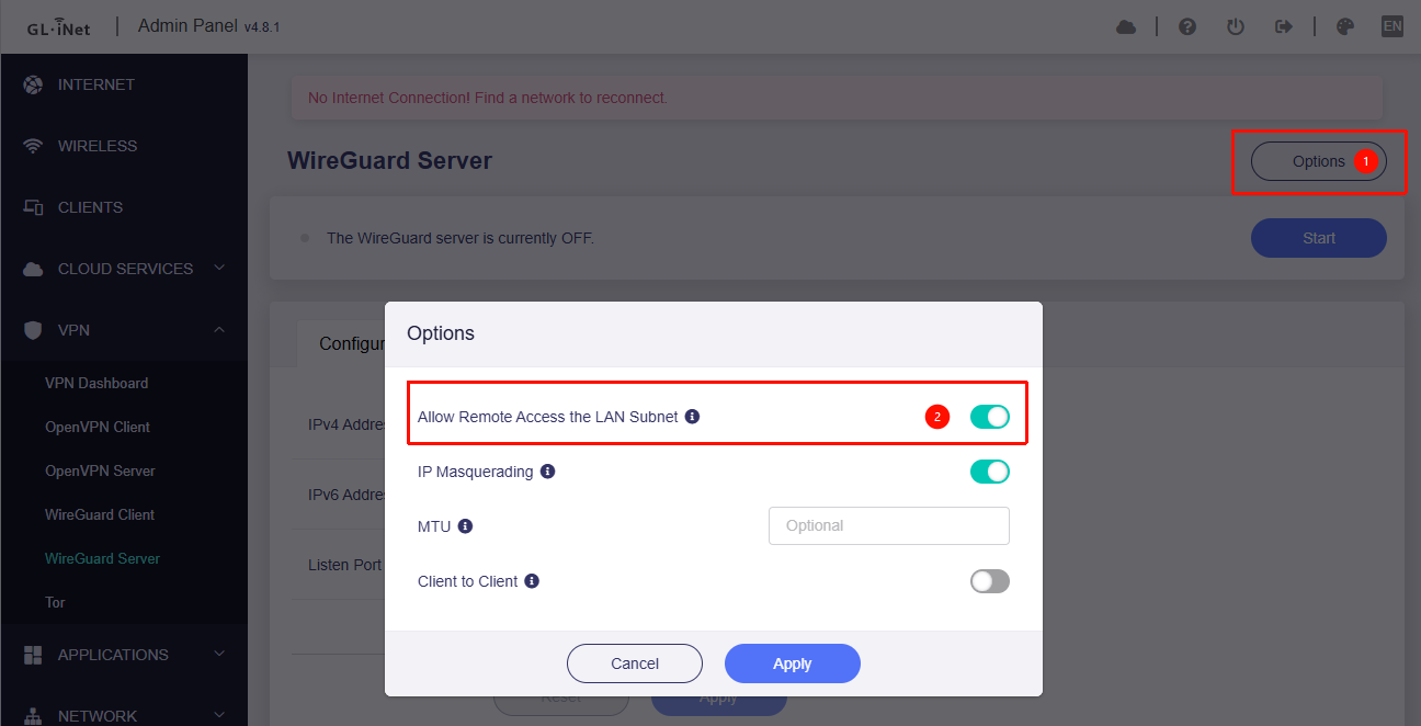

  • On the WireGuard server side:
  1. Go to Admin Panel → VPN → WireGuard Server, and configure routing to the WireGuard client’s subnet.
  2. Enable the "Allow Remote Access to the LAN Subnet" so the LAN devices from WireGuard Client side could access the LAN devices on WireGuard Server side.

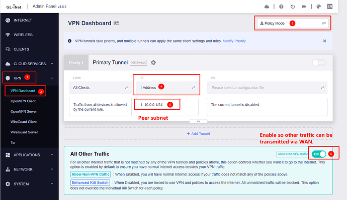

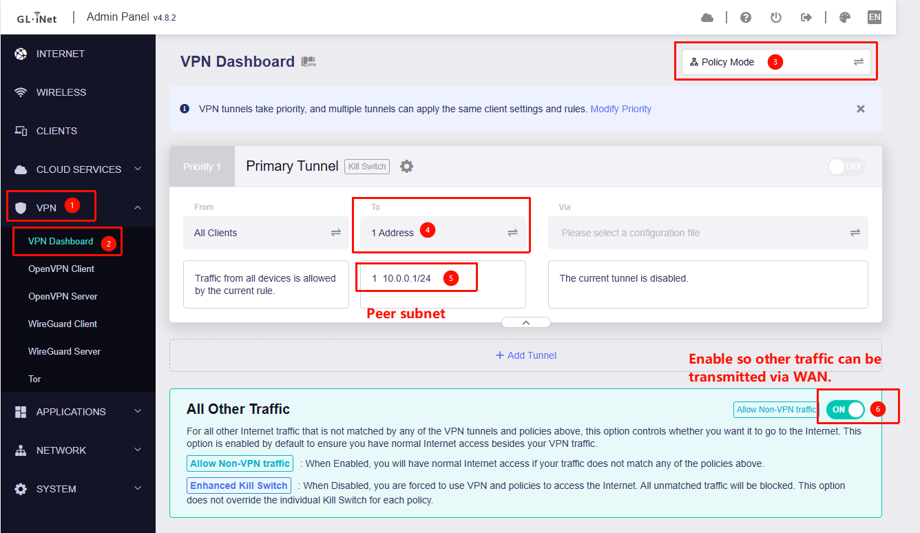

  • On the WireGuard client side:
  1. Go to Admin Panel → VPN → VPN Dashboard, switch to Policy Mode, and configure it so that only traffic destined for the remote subnet goes through the VPN.
  2. Enable the "Allow Remote Access to the LAN Subnet" so the LAN devices from WireGuard Server side could access the LAN devices on WireGuard Client side.

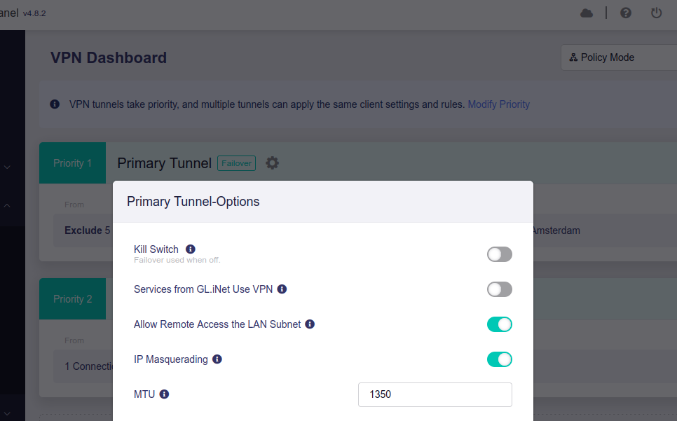

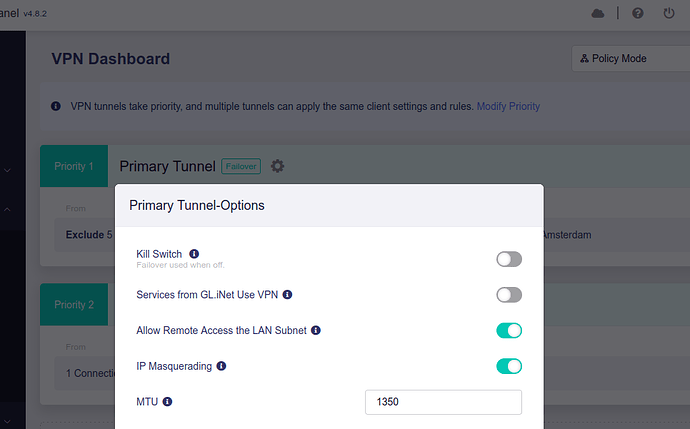

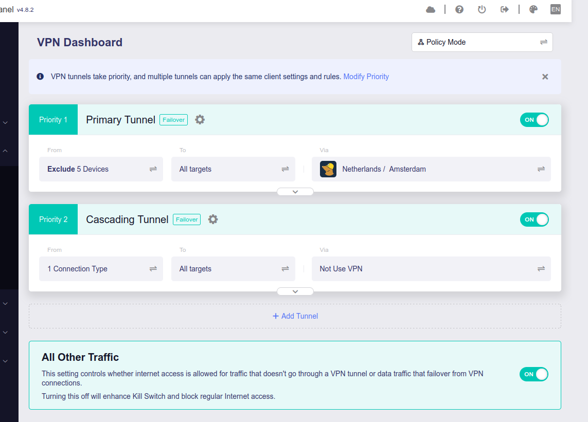

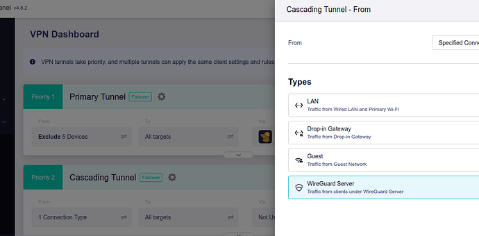

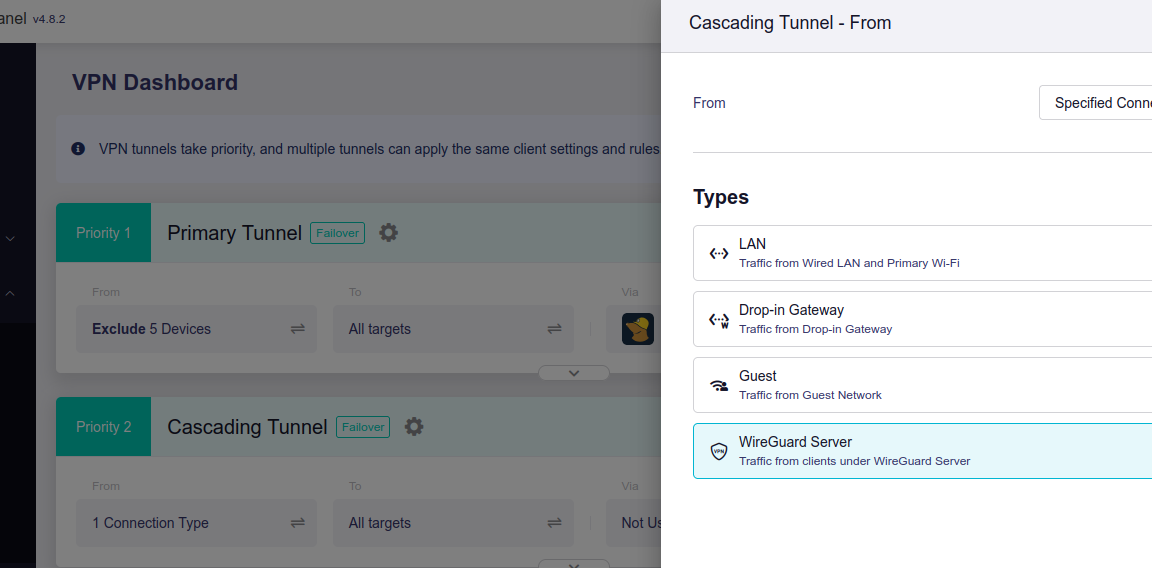

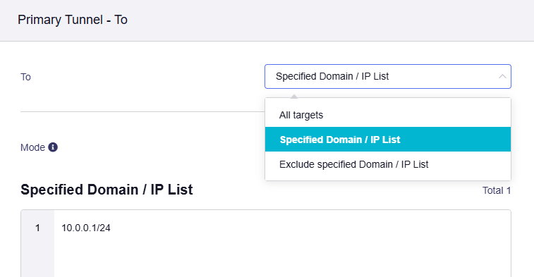

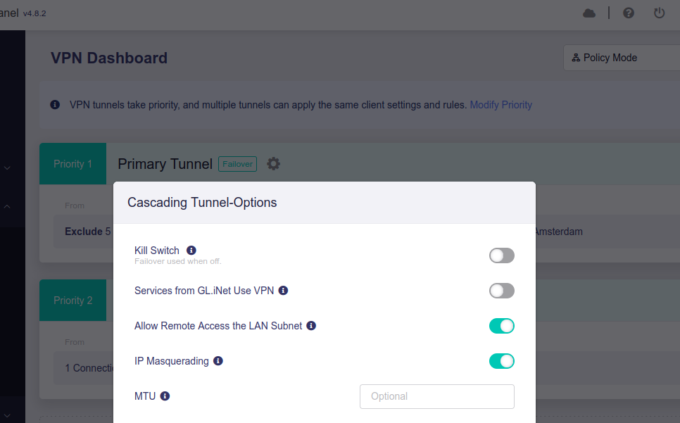

Great. I made the setup. Just running into an issue because the wg server side is also using policy mode to exclude some devices. It might be I set that up wrong because I cannot connect to wg client lan network.
This is the set up on wg server side
any ideas?
The settings in the screenshots you provided don’t appear to affect the S2S scenario.
Have you tried or checked the configuration based on the steps we previously shared?
If you’re not familiar with it or are still experiencing issues, you may consider sharing the device via GoodCloud so we can help review and configure it for you.
All the settings are as in the example.
Only I can see that client MTU = 1420 and server MTU = 1320 is this a problem?

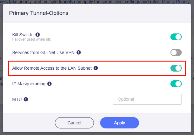

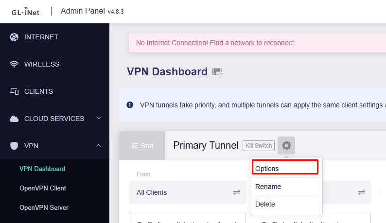

Sorry, we may have missed a step earlier. Please refer to the updated guide and try the following again:
As you can see in my second screenshot above. it was already on.
But isn't the screenshot supposed to show the WireGuard server side?

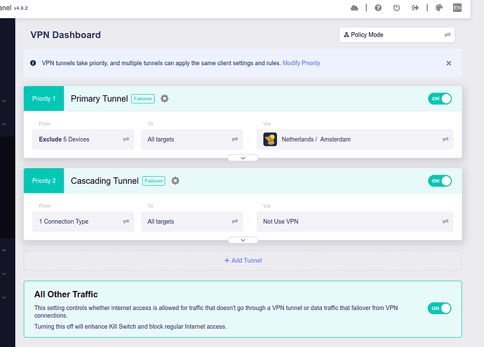

We can see that it is running a commercial VPN tunnel, and that traffic designated to come from the WireGuard server is not being transmitted via the VPN.
Perhaps we’ve misunderstood your setup.
Could you please clarify further?
On the wg server the option allow LAN subnet is set to ON.
The primary tunnel sends or excludes traffic for some LAN clients.
The cascading tunnel excludes WG server clients from using the VPN.
So that should work right?
