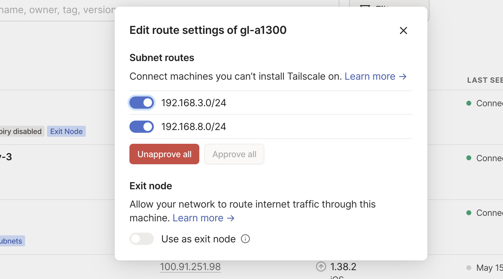

I found the subnet allowed on gl-a1300 has 192.168.1.0/24, while you exit node device has also the network of 192.168.1.0/24. This will cause conflict.
Please change one of the network to a different subnet to locate the issue.
Hi @hansome,
Done! But unfortunately the issue still remains. As soon as I toggle the “custom exit node” switch, all clients connected to Slate lose internet access.
The Slate Plus now sits on 192.168.3.x
I have also adjusted the subnet routes in Tailscale:
