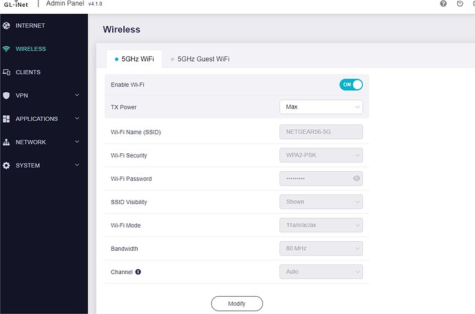

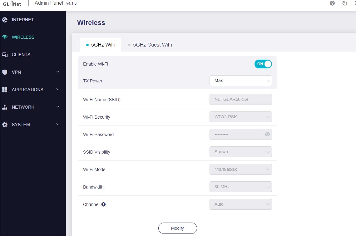

Also post the screenshot of your 5G wifi settings for reference.

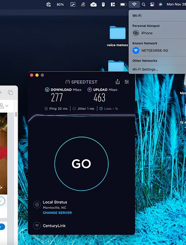

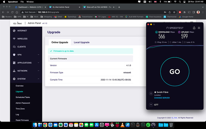

here screenshots of Ethernet speed - which is normal. and 5gz wifi settings screenshot below.
And here is screenshot with wifi 5ghz - i was standing right next to the router. Upload speed i think is ok. download is terrible.

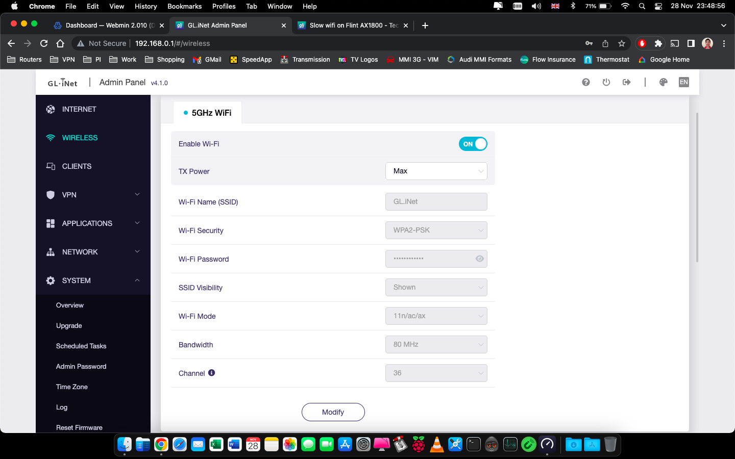

i see you have the channel set to 36 - what happens if you set to auto? does speed remain same?
first time updated from 3.214 via uboot with .img to 4.0.1 beta. after that updated with .tar for every new beta versions until the stable 4.1.0 (or beta 4.1.0 release 6).
i’m using channel 36 as all other channels are used by my neighbours apart from 36. if i’ll set it on auto will pick 36 so… 36 :slight_smile:

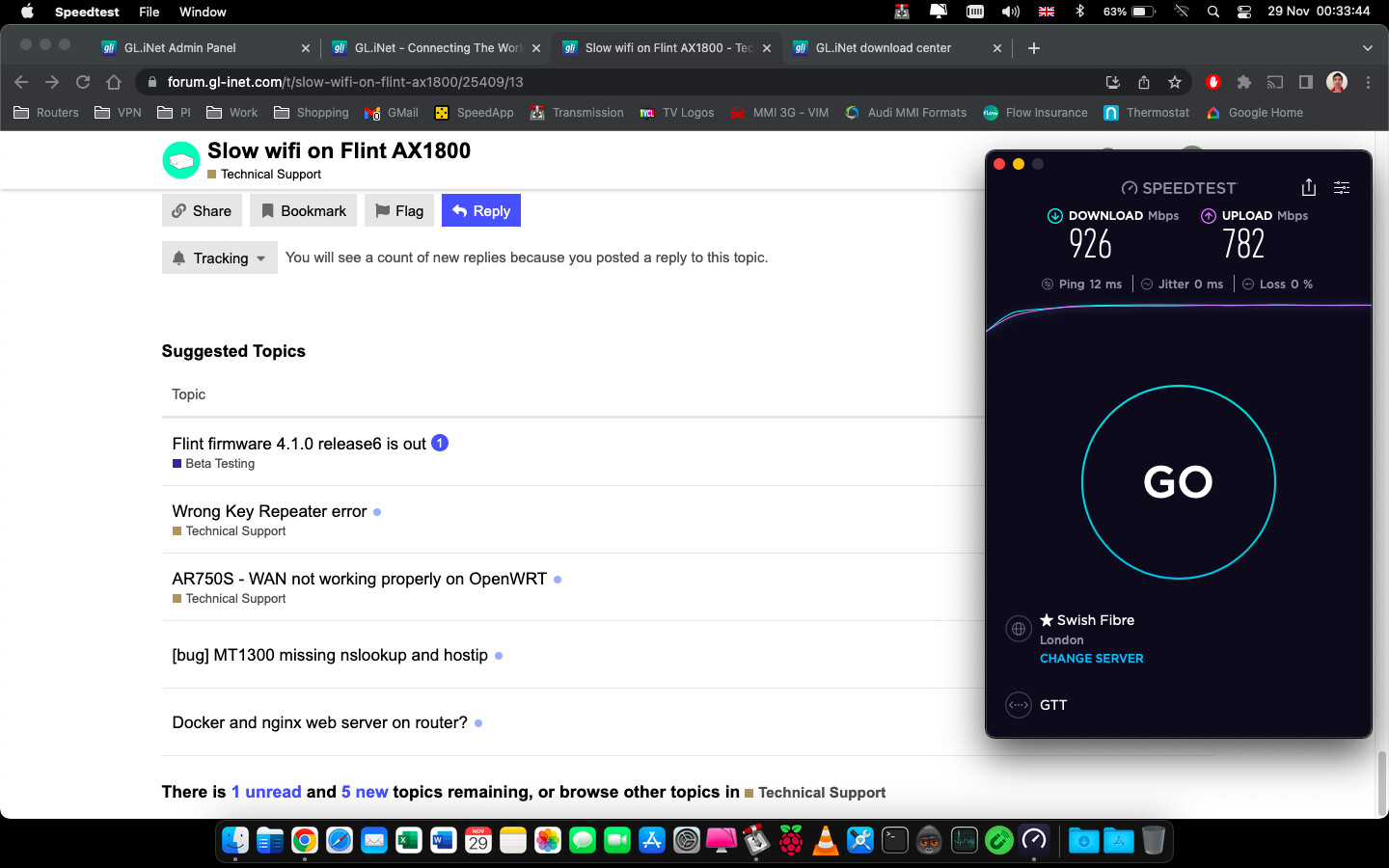

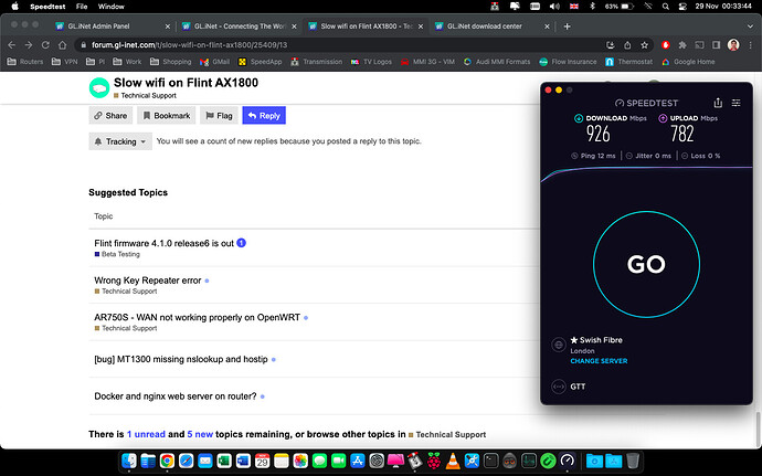

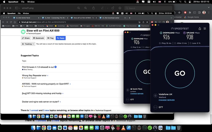

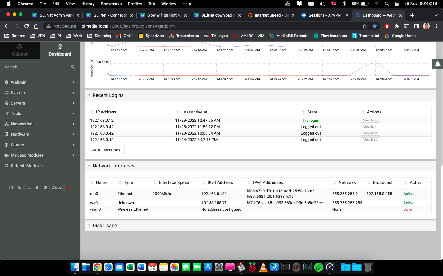

and wired:
and VPN (wireguard) wired (raspberry pi 4) speeds (server is 1600 miles away therefore ping is a lil bit high) but not important for my needs with vpn:

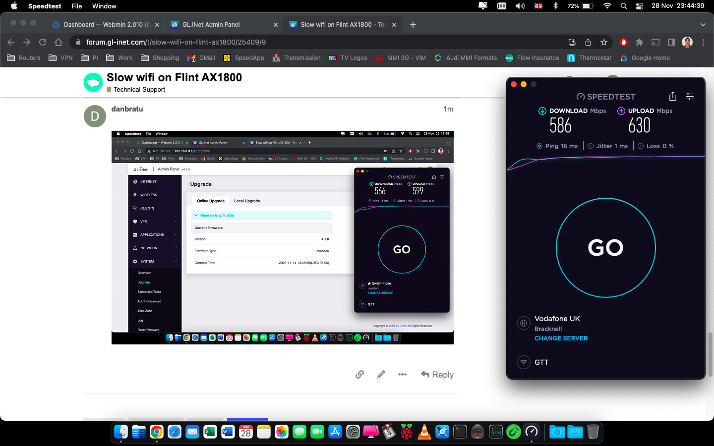

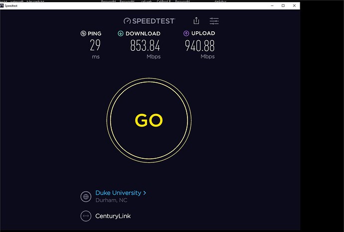

The 277, 463 speed test is on 5G wifi? So what is tyhe 566, 599 speedtest? Also the same right?
I notice that the speedtest server is different. Can you choose the same server?
That wasn’t me - that was the other user’s picture.

in am located in UK, he’s in US. picking the same server will not be relevant. i’ve picked a server 80 miles away and another one 60 miles away
the answer to your question might/should come from a GL.iNet engineer/developer. i am just an user…
