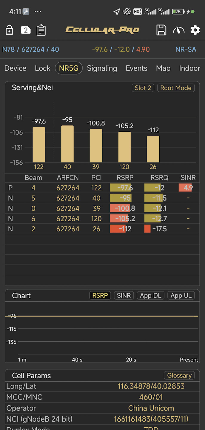

Additionally, please try using the same SIM card on an Android phone, download an app like Cellular Pro , and take a screenshot of the current 5G network connection details so we can further assess the situation.
