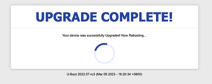

So just an update and a HUGE thank you to Bruce & John @GL.i tech support.
Bruce gave me a couple of links and suggested I upgraded the uBoot on the device. I tried and failed multiple times. What worked in the end?
Renaming the files from "X3000_uboot_fip.bin" to "uboot.bin" and uBoot updated.
Then from there I updated the firmware, again, I renamed it from "openwrt-x3000-4.7.4-0317-1742206344.1.bin" to "openwrt.bin", this took a couple of attempts (not sure if I was doing something wrong), but I realised once the firmware is updated, you need to log into 192.168.8.1
Now I have my Spitz AX up and running again (firmware v4.7.4 thanks to Bruce).
