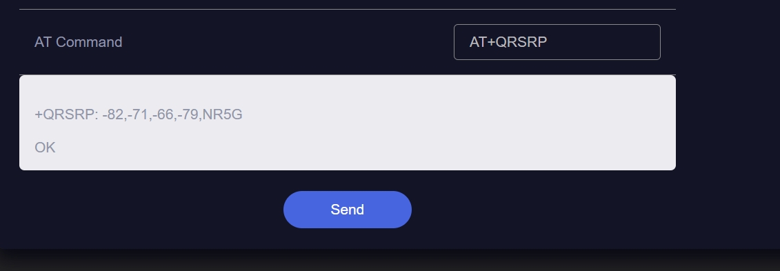

Well I had some time to really invest on trying to figure this out. I noticed when running AT+QRSRP that the very first (Primary) number was -106 which is pretty crappy. This is connected to N25/N41 SA which gives me the best overall speeds (minus the horrible upload on the Spitz). I decided to connect the Spitz to my Waveform 4x4 mimo antenna. I wanted to confirm that the side antenna ports were indeed the main ports so I left the two back antennas off and ran AT+QRSRP. Afterward the last two numbers were horrible and confirmed the side ports are the mains. Yes I know the one port is labeled main already…just trying to satisfy my OCD. Anyway I connected the Spitz to my waveform and my numbers have improved quite a bit. I’m posting some pics that speak for themselves.
With all of the above said…I never had low upload issues with my Suncomm devices on the stock stick antennas.

There’s definitely something a miss with the antenna reception. It’s disappointing that I have to connect the Spitz to my Waveform 4x4 to get the same upload performance as my Suncomm devices with their factory stick antennas.
