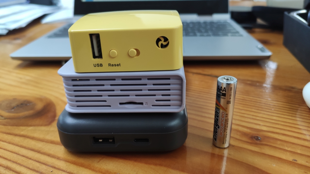

Just as a quick sizing comparison Mango , Brume(same size as Creta), Mudi. AAA battery for size reference. :slight_smile:
As far as integrated battery, sorry, for your use case I really can’t think of any driving factor to buy a MiFi or a Mudi for the additional cost. I mean I love my Mudi, but I have certain locations where I need to rely on 4G connection. I don’t know much about the RavPower units so can’t tell you how good they are from a user interface , performance or firmware upgrade perspective. Can only tell you what I know :slight_smile:
