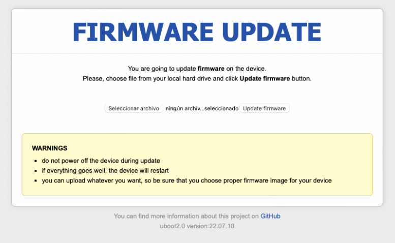

I have done the UBOOT procedure but it doesn’t seem to do anything. I have tested the next firmware:
openwrt-ax1800-4.1.0-1114-1668412657.img
qsdk-ax1800-3.214-0509.img
qsdk-ax1800-3.213-0325.img
I think it does upload the firmware really fast, it takes less than 30 seconds, with restart included. I have done this in Mac OS (using Safari and Chrome) and in a Windows 10 pc (Using edge). I have used a different ethernet cable but the same result blue light and no ip and no gl-inet menu.
after flashing the uboot, are you getting the firmware page at 192.168.1.1?
The LED is solid blue?
The uboot process does work very fast.
Yes I can get the firmware page.
The led flashes 5 times then goes white and I enter the firmware page. After flashing the led remain solid blue.
I change the dhcp options to automatic, but I never get right ip to enter the router. I just get an auto assign ip 169.254.128.179

I see. It should work with our firmware. Which file exactly did you use? Pls be sure use the .img file.
you want to flash the uboot first not the firmware. That’s at gateway_ip/uboot.html. Going to the gateway address will show you the firmware page and not the uboot. The two pages look similar but are different!
You need to flash the uboot from
https://github.com/gl-inet/uboot-ipq60xx/blob/master/uboot-gl-ax1800-20220711-md5-9890c67c3dafa5aec172f3a31583f9a7.bin?raw=true
Then go to 192.168.1.1\uboot.html
Select the file you just downloaded above and flash it.
This takes seconds however you should then be able to use the reset pin method as described by gl-inet to get back into webgui for flashing images then flash the firmware you want to flash.
