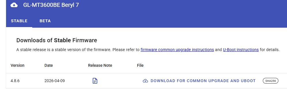

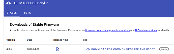

If you upgrading to the stable version 4.8.6 doesn't solve the problem?
If that's the case, when WiFi problems occur, could you connect to the router's LAN port, access the GUI, export the router logs, and send them to us for inspection?
Just updated to stable 4.8.6 today. Since the issue takes a while to show, I’ll have to wait for it to happen again.

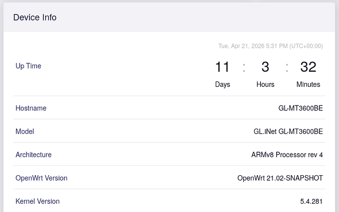

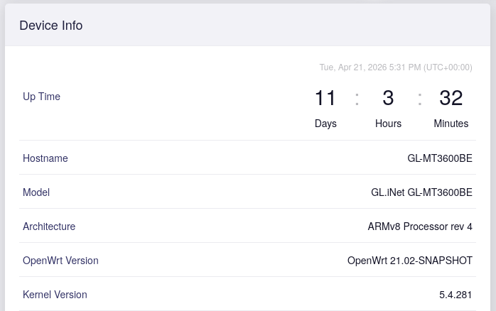

I started experiencing jitter during calls today, took the opportunity to update to 4.8.7 and restart the device. I’m not sure the jitter was introduced by router or VPN.
Device had been running for 11 days and the issue hasn’t happened again. Will continue to monitor.
