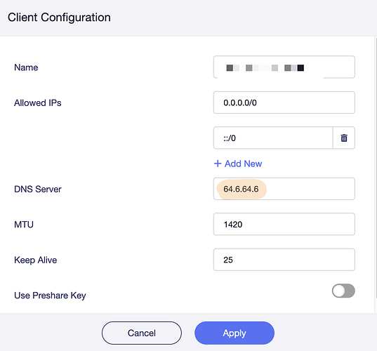

I initially had my DNS configured in the Network > DNS section. Then, I enabled AdGuard instead. In both instances, directly connected (via Ethernet) PCs had no problems accessing the Internet (and that’s still the case).
Additionally, when Wireguard VPN profiles are created, there is an option to set the DNS. If you don’t set this to anything different, the Brume 2 automatically sets it to what you see in this screenshot:

Soon after connecting, I start getting connection errors on my phone/connected device.
In my logs, I see things that look like IPv6 address mapping going on, but IPv6 is disabled on the Brume 2 (due to the warnings about leakage). I have IPv6 enabled on the rest of my home network, so maybe that is the issue. I’m not sure.
Since you have Adguard enabled
Your wireguard default dns should be your Brume router (don’t forget to enable ‘allow remote access lan’ at VPN dashboard - wireguard server)
Another way of quick check maybe set the wireguard dns to 1.1.1.1 just to see if you get internet
I’m still getting what appear to be DNS resolution issues. For example, I can receive notifications and data (e.g., emails) on already-established connections. However, as soon as I do anything that requires a nameserver lookup, it breaks.
That means it’s still not working
Does your ‘existing router’ block any other dns settings
No, my existing router is just a Netgear Orbi system configured with preferred, standard IPv4 DNS servers (to NextDNS). I have NextDNS bound to my home IP so DNS requests to their generic servers that come from my house are automatically processed by them using my custom configuration. However, I don’t believe this is the cause of the issue since I’ve also tried configuring the Brume 2 in front of my router (between my cable modem and the Orbi router) and had the same, exact problems (which do appear to be DNS-based). This is the only DNS configuration I have on my router:
I’ll add that on my phone, I also have the NextDNS app, but I disabled it for testing. When I disable WiFi and go cellular-only to test the VPN, I have no special DNS settings pre-applied to my phone and it picks up the default DNS servers from my carrier (T-Mobile).
I’m doing more testing. I disabled AdGuard and set my VPN DNS server to my router (192.168.1.1). I am actually able to see my DNS requests getting processed on NextDNS from my phone while connected to the VPN. I am betting that the problem may be related to getting IPv6 returns while IPv6 is disabled on the Brume 2. The warnings on the Brume 2 reference IP leakage on VPN when IPv6 is enabled, but is that related to the VPN server, the client, or both???
what dns setting did you use on your mobile phone wireguard app ?
since you disabled adguard, can you enable ‘encrypted dns - dns over tls - cloudflare’ and ‘override dns settings for all clients’
I just tried enabling Encrypted DNS over TLS to Cloudflare and can verify that it works when I have a PC wired into the Brume’s LAN port over Ethernet:
However, when I generate WireGuard configs, the configs all still default to that funky “64.6.64.6” address. I can override that with 1.1.1.1, but DNS fails as soon as I am connected to the VPN (checking with dnscheck.tools).
How is your Rx tx look like? Is the VPN really established
I think I may have discovered the issue. My cellular provider uses the T-Mobile network, which is IPv6-only and my phone is iOS. It looks like I need to find a way to test on another network…though it also means that my phone will not work on the VPN unless it’s on WiFi. See: https://community.t-mobile.com/network-coverage-5/possible-to-connect-to-an-ipv4-vpn-server-on-t-mobile-with-ios-9471
I can confirm that the T-Mobile mobile network appears to be the culprit due to its lack of support for IPv4 combined with the Brume 2’s current lack of support, where the VPN is concerned, for IPv6. Everything seems to be working great on on IPv4-supporting networks.
I have been trying to get Wireguard VPN server setup and and using my Pixel 7 Pro with the wireguard client app and having the same issue. I am on the MINT mobile network that uses T-mobile and this would explain why I am having DNS issues.
As a side note, my Flint router has 4.2 RC2 which has Tailscale and that works perfectly with my phone. So see if you can Tailscale is available on the Brume2.
Hopefully an update can fix this DNS issue, I also don’t want to enable IPv6 yet.
That’s great information on Tailscale. I’ll have to look into it.
It looks like I’ll have to wait for the 4.2 firmware to hit stable before playing with Tailscale on the Brume 2. I have it on my Beryl AX since it’s already got 4.2 stable. Hopefully it doesn’t take too long :slight_smile:
