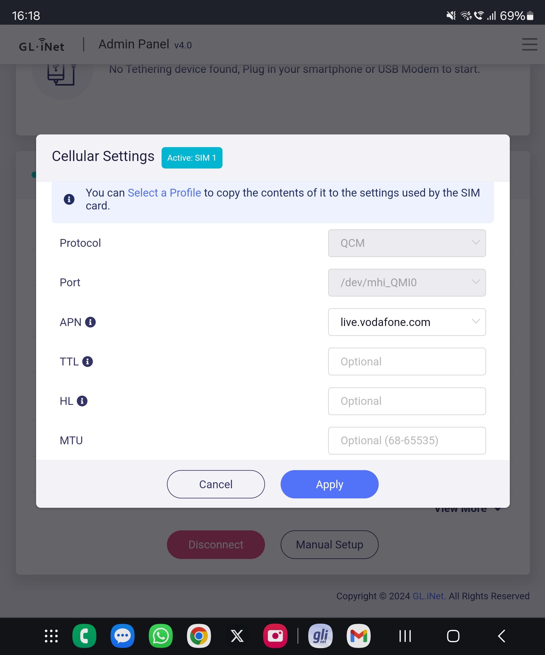

Can you share your sms send screenshot before hitting the send please?

Can you refer to this post to try something out?
