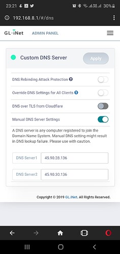

Manual Configuration is properly done.

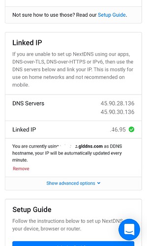

DDNS on NextDNS website is set properly and it is working to update IP.

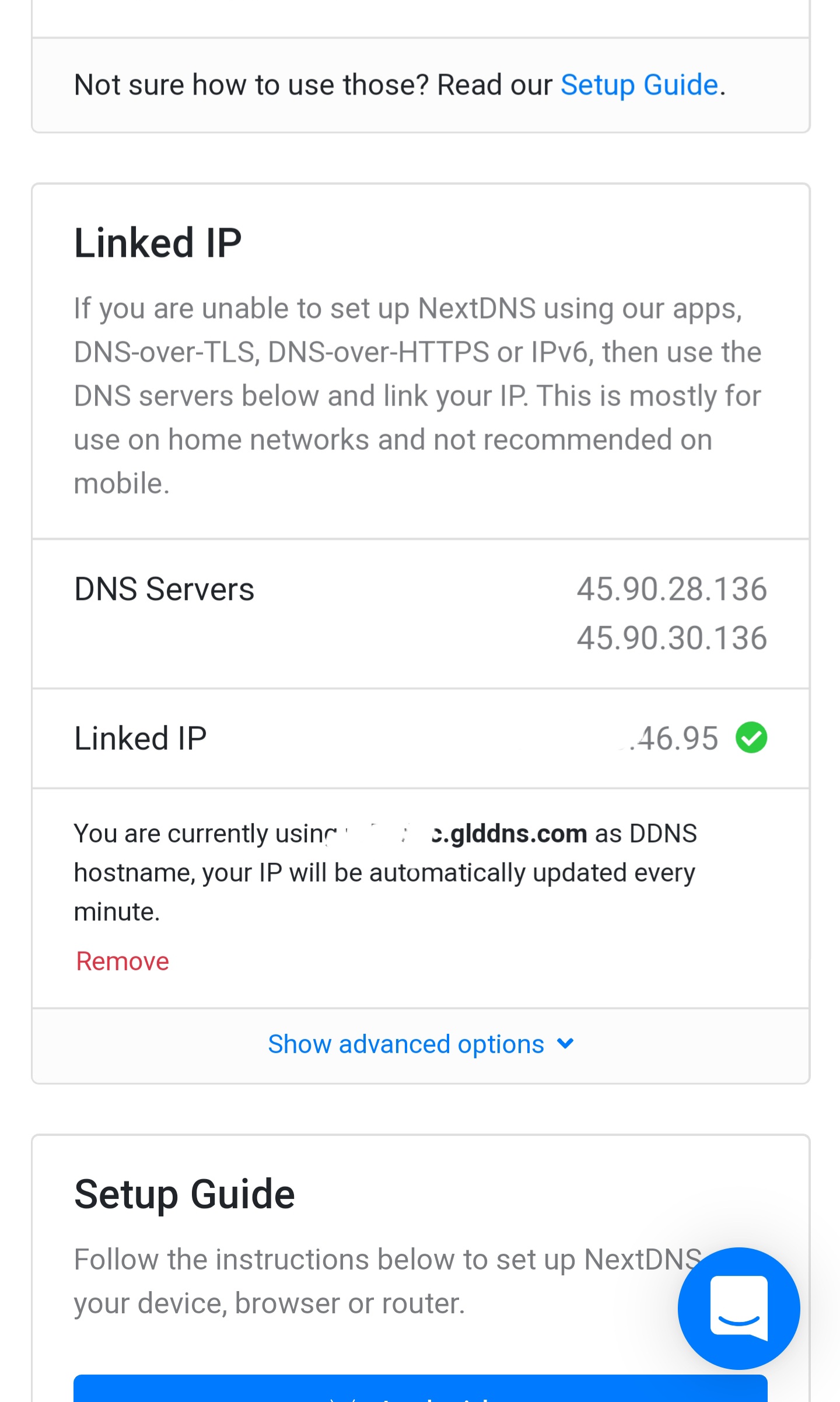

when using manual dns you have to set it so it recognizes your real ip address in the nextdns dashboard. your real ip address may have changed if it all correct.
click the “link ip” from the nextdns dashboard
or
click advanced in the link ip section and find:
You can also programmatically update your linked IP by calling:
https://link-ip.nextdns.io/xxxxx/xxxxxxxxxx

My IP is automatically updating every minute as I have set to use DDNS from Gl-inet and DDNS is working perfectly fine and IP is linked.

I have reset my router and using the manual entry of DNS servers from Web UI (the very easy way) nothing with router OS.
I am sharing my vpn policies, DNS servers set, DDNS.
Edit: If I disable and re-enable some settings like “DNS for all clients” nextDNS starts working again for next few minutes.
