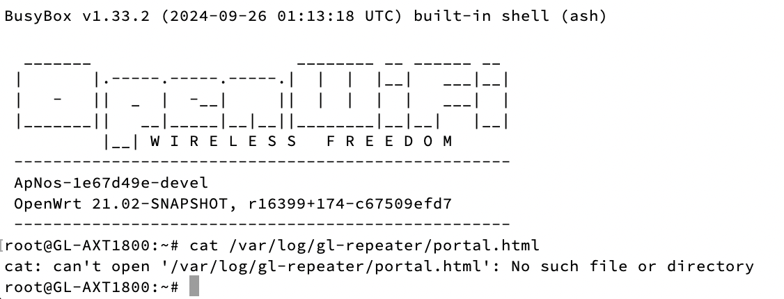

Please show the file.
/var/log/gl-repeater/portal.html
What is this for? @FooBeard
@mudi-npc JerryZhao asked for a log.
@JerryZhao I'm not sure how you access that file in the UI. I'm guessing via SSH, but I don't see anything. Maybe it doesn't persist. In that case I don't have it any longer.
All logs are flushed on reboot / power-loss.
I'm going to be on another MSC cruise next week and can send more logs. The logread.tar was the ui exported logs from when the issue was occurring. I didn't know there were additional logs via ssh.
