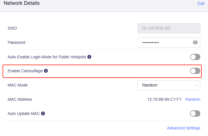

"camouflage device" sets some other MAC address. AFAIK you have no control over that MAC address. The first 6 hex digits will be identical to your phone (doing the camouflage for the OUI , the last 6 hex digits appear to be random like with local administred MAC addresses, that is stable for the same network for some time) Stopping and starting the camouflage might give another MAC address.

May I know did you enable the Camouflage mode of repeater?
I thought I read that MSC is blocking Nord VPN traffic. I leave on Aug 3rd. I really need to know if this reallys works. I planned on buying two routers. One for each cabin. As i have already paid for browse and stream for each cabin, but only 1 device in each cabin. I've had Nord VPN for years. Will it still work on MSC?
You can try to purchase Beryl AX, Slate AX, Slate 7, etc, since they supported Camouflage mode of repeater.
After enabling this feature, you shall be able to connect to MSC portal WiFi. If no luck, please contact us and try to debug in PC remote desktop.
