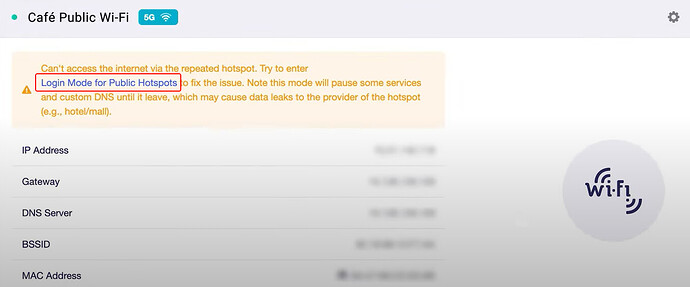

May I know if Beryl AX does not enable VPN client, and without clone the phone MAC, connect to MSC portal WiFi in repeater like a normal tourist user, and enable auto-login and camouflage mode, after the repeater connected and got the IP, can the Beryl AX automatically obtain the MSC portal URL (Login mode for public hotspots), is it normal for the browser to access the URL?
I tried with the camouflage mode, seems like the Beryl AX can obtain the MSC portal URL. I clicked the hyperlinke which you marked as red, it redirects me to a MSC page, but the page keeps loading so after 2 minutes I stopped waiting and cancelled it.

If the MSC page does not load, I think there may be something need to check.
Please help us and test these:
  1. When camouflage mode is toggle off, the repeater is connected to MSC WiFi, can the redirect link be obtained? Can the MSC page be loaded? Please export the syslog.
  2. When camouflage mode is turned on, the repeater is connected to MSC WiFi, can the redirect link be obtained? Can the MSC page be loaded? Please export the syslog.
  3. Please SSH to the router, execute cat /var/log/gl-repeater/portal.html, copy the result here.
