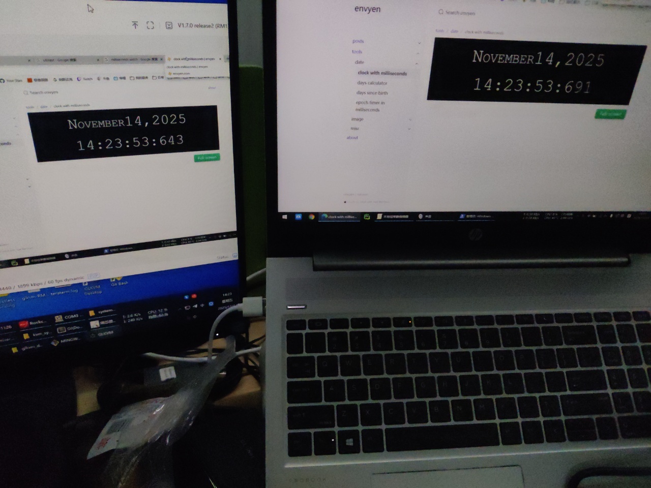

YES, we have disabled the zero-latency mode in the smart mode, as it tends to cause more stuttering in scenarios like WiFi connections. However, the normal mode should perform consistently.
I retested the latency in normal mode + ultra-high on RM1 1.7 R2, and it still remains between 40-60ms within the local network.

Can you provide a screen recording? For this kind of lagging issue, logs usually don't reveal much.

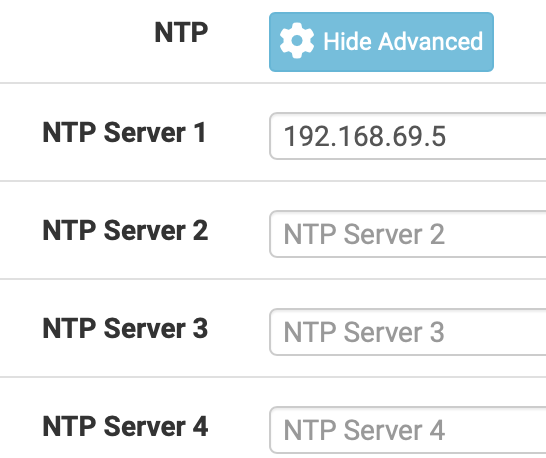

They elected to remove NTPD and just let CONNMAND sync time. If your DHCP server supports configuring a NTP server, CONNMAND will prefer that.
Example from pfSense
Otherwise, you can add a custom S20update_ntp.sh file to the /etc/kvmd/user/scripts folder, which will persist on reboot or firmware upgrade.

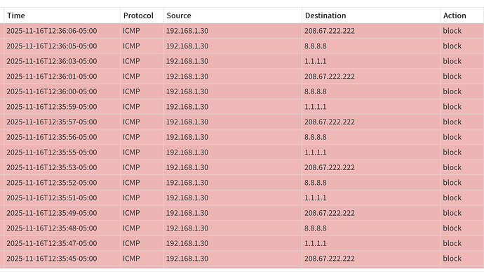

Looks like the new firmware hasn’t stopped the constant pinging of public DNS servers (literally) every 5 seconds either just to update the status light.

/bin/sh /etc/init.d/S23led stop
https://forum.gl-inet.com/t/excessive-icmp-ping-flood/64904/10?u=elvisimprsntr

GLKVM is running an older version of CONNMAND, which has documented issues bombarding NTP servers during initialization.
connmand -v
1.44
What’s happening in ConnMan 1.44
  • Aggressive retry loop: This version doesn’t implement exponential backoff for NTP queries. If the first few requests fail, it keeps hammering the servers.
  • FallbackNTPServers: Defaults to Google’s public servers (time1.google.comtime4.google.com). These servers rate‑limit, so repeated bursts get ignored.
  • Result: ConnMan never successfully syncs the clock because the servers stop responding after too many requests.
ConnMan 1.45 introduced improved NTP (Network Time Protocol) support, focusing on reliability, fallback handling, and tighter integration with system time services.
:magnifying_glass_tilted_right: Key Improvements in NTP Support (ConnMan 1.45)
  • Better fallback logic:
    • If the primary NTP server fails, ConnMan now cycles through configured servers more intelligently.
    • Reduces long delays in time synchronization on embedded devices.
  • Enhanced IPv6 support:
    • NTP queries now handle IPv6 addresses more consistently, ensuring proper operation in dual-stack networks.
  • Improved error handling:
    • Clearer logging when NTP synchronization fails.
    • Automatic retries with exponential backoff to avoid flooding the network.
  • Integration with systemd-timesyncd:
    • ConnMan can delegate time synchronization to systemd’s timesyncd when present, avoiding conflicts.
    • This ensures smoother coexistence with distributions that rely on systemd for timekeeping.
  • Plugin refinements:
    • The NTP plugin was updated to better handle DNS resolution of pool.ntp.org servers.
    • Improved caching of resolved NTP server IPs to reduce repeated lookups.
  • Security patches:
    • Fixes for CVEs related to malformed NTP responses that could previously cause crashes or memory leaks.
    • Hardened parsing routines to prevent buffer overflows.
  • Performance optimizations for embedded devices.
You also might want to step up to a more modern Linux kernel. The current version is 5 years, 8 months old.
uname -r
4.19.111
Linux kernel 4.19.111 is known to have multiple documented vulnerabilities (CVEs), including privilege escalation, denial of service, and information leaks.
:magnifying_glass_tilted_right: Key Details
  • Total CVEs: Over 4,000 vulnerabilities have been reported across the 4.19.x series, with many affecting 4.19.111 specifically.
  • Types of vulnerabilities:
    • Privilege Escalation: Attackers can gain higher-level access than intended.
    • Denial of Service (DoS): Crashes or hangs caused by malformed inputs.
    • Information Leaks: Kernel memory exposure to user space.
    • Code Execution: Exploits that allow arbitrary code to run.
  • Examples of CVEs impacting 4.19.x (including 4.19.111):
    • CVE-2019-19083 – Memory leak in AMD GPU driver.
    • CVE-2018-18281 – Improper TLB flush in mremap, leading to memory corruption.
    • CVE-2025-40179 – Ext4 filesystem orphan file handling flaw, causing excessive memory consumption.
UPDATE: Submitted a bug report to hopefully give this some traction.
https://github.com/gl-inet/glkvm/issues/72#issue-3635391839
In regards to the NTP server that’s all well and good that it can pull the time server from DHCP, but let’s just have an option to configure it in the KVM Web UI and skip the extra steps.
I wound up editing /etc/connman/main.conf and commented out the Fallbacks and put my preferred (local) time server in there. I don’t want fallback non-local NTP server or fallback non-local DNS servers. I want the ones I specify.
bash-5.2# cat main.conf
[General]
#FallbackTimeservers = pool.ntp .org,time.google .com,ntp.aliyun. com
FallbackTimeservers = time.lan
#FallbackNameservers = 8.8.8.8 8.8.4.4 1.1.1.1 1.0.0.1
FallbackNameservers = 192.168.20.1
I think the bombarding of NTP servers with NTP packets is different than the bombarding of the DNS servers with pings.
