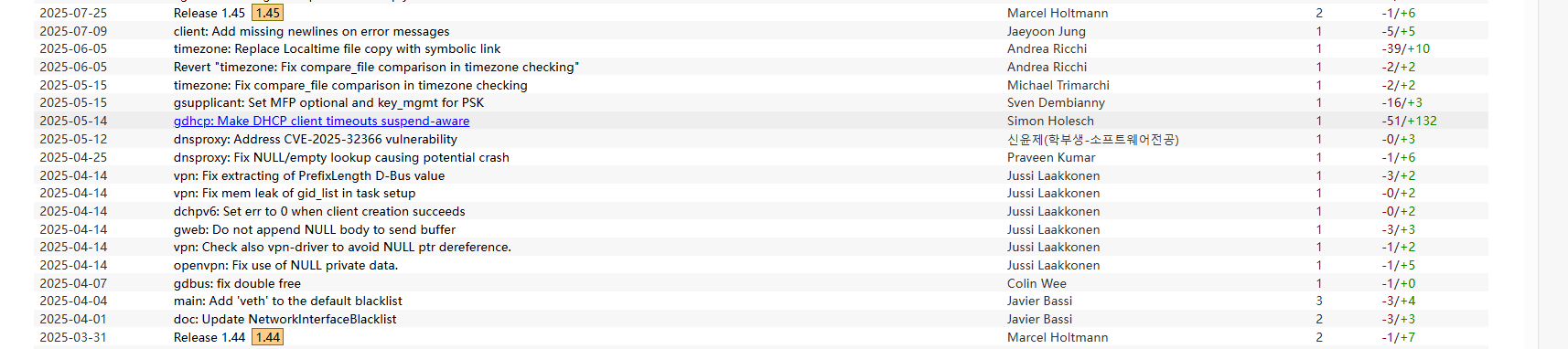

ConnMan 1.45
I really hope you're not just replying to me with AI-generated responses.
connman/connman.git - Connection Manager
There is no NTP-related fix in here.
Well then ConnMan is the worst choice for synchronizing time. Give us NTP back and the ability to neuter ConnMan time synchronization. Because all it does it pollute NTP servers and never synchronizes time.

	  Originator Timestamp: 0.000000000
	  Receive Timestamp:    0.000000000
	  Transmit Timestamp:   2208988849.000767875 (1970-01-01T00:00:49Z)
	    Originator - Receive Timestamp:  0.000000000
	    Originator - Transmit Timestamp: 2208988849.000767875 (1970-01-01T00:00:49Z)
21:36:17.870508 64:62:66:21:c8:40 > 94:83:c4:bb:17:1f, ethertype IPv4 (0x0800), length 90: (tos 0xb8, ttl 64, id 21017, offset 0, flags [none], proto UDP (17), length 76)
    192.168.69.5.123 > 192.168.69.60.41726: [bad udp cksum 0x0bdc -> 0xbbcf!] NTPv4, Server, length 48
	Leap indicator: clock unsynchronized (192), Stratum 0 (unspecified), poll 10 (1024s), precision 0
	Root Delay: 0.000000, Root dispersion: 0.000000, Reference-ID: (unspec)
	  Reference Timestamp:  0.000000000
	  Originator Timestamp: 2208988849.000767875 (1970-01-01T00:00:49Z)
	  Receive Timestamp:    2208988849.000767875 (1970-01-01T00:00:49Z)
	    Originator - Receive Timestamp:  -0.000000000
	    Originator - Transmit Timestamp: -0.000000000
21:36:22.872270 94:83:c4:bb:17:1f > 64:62:66:21:c8:41, ethertype IPv4 (0x0800), length 90: (tos 0x10, ttl 64, id 18765, offset 0, flags [DF], proto UDP (17), length 76)
    192.168.69.60.42037 > 192.168.69.5.123: [udp sum ok] NTPv4, Client, length 48
	  Transmit Timestamp:   2208988854.001257285 (1970-01-01T00:00:54Z)
	    Originator - Transmit Timestamp: 2208988854.001257285 (1970-01-01T00:00:54Z)
21:36:24.869813 94:83:c4:bb:17:1f > 64:62:66:21:c8:41, ethertype IPv4 (0x0800), length 90: (tos 0x10, ttl 64, id 19332, offset 0, flags [DF], proto UDP (17), length 76)
	  Transmit Timestamp:   2208988856.000699423 (1970-01-01T00:00:56Z)
	    Originator - Transmit Timestamp: 2208988856.000699423 (1970-01-01T00:00:56Z)
21:36:28.870334 94:83:c4:bb:17:1f > 64:62:66:21:c8:41, ethertype IPv4 (0x0800), length 90: (tos 0x10, ttl 64, id 20531, offset 0, flags [DF], proto UDP (17), length 76)
	  Transmit Timestamp:   2208988860.000831438 (1970-01-01T00:01:00Z)
	    Originator - Transmit Timestamp: 2208988860.000831438 (1970-01-01T00:01:00Z)
21:36:28.870481 64:62:66:21:c8:40 > 94:83:c4:bb:17:1f, ethertype IPv4 (0x0800), length 90: (tos 0xb8, ttl 64, id 45673, offset 0, flags [none], proto UDP (17), length 76)
    192.168.69.5.123 > 192.168.69.60.42037: [bad udp cksum 0x0bdc -> 0x3b33!] NTPv4, Server, length 48
	  Originator Timestamp: 2208988860.000831438 (1970-01-01T00:01:00Z)
	  Receive Timestamp:    2208988860.000831438 (1970-01-01T00:01:00Z)
21:36:33.872665 94:83:c4:bb:17:1f > 64:62:66:21:c8:41, ethertype IPv4 (0x0800), length 90: (tos 0x10, ttl 64, id 21373, offset 0, flags [DF], proto UDP (17), length 76)
    192.168.69.60.56003 > 192.168.69.5.123: [udp sum ok] NTPv4, Client, length 48
	  Transmit Timestamp:   2208988865.001396052 (1970-01-01T00:01:05Z)
	    Originator - Transmit Timestamp: 2208988865.001396052 (1970-01-01T00:01:05Z)
21:36:35.869306 94:83:c4:bb:17:1f > 64:62:66:21:c8:41, ethertype IPv4 (0x0800), length 90: (tos 0x10, ttl 64, id 21394, offset 0, flags [DF], proto UDP (17), length 76)
	  Transmit Timestamp:   2208988867.000611180 (1970-01-01T00:01:07Z)
	    Originator - Transmit Timestamp: 2208988867.000611180 (1970-01-01T00:01:07Z)
21:36:39.871854 94:83:c4:bb:17:1f > 64:62:66:21:c8:41, ethertype IPv4 (0x0800), length 90: (tos 0x10, ttl 64, id 22418, offset 0, flags [DF], proto UDP (17), length 76)
	  Transmit Timestamp:   2208988871.001220498 (1970-01-01T00:01:11Z)
	    Originator - Transmit Timestamp: 2208988871.001220498 (1970-01-01T00:01:11Z)
21:36:39.872000 64:62:66:21:c8:40 > 94:83:c4:bb:17:1f, ethertype IPv4 (0x0800), length 90: (tos 0xb8, ttl 64, id 13312, offset 0, flags [none], proto UDP (17), length 76)
    192.168.69.5.123 > 192.168.69.60.56003: [bad udp cksum 0x0bdc -> 0x862f!] NTPv4, Server, length 48
	  Originator Timestamp: 2208988871.001220498 (1970-01-01T00:01:11Z)
	  Receive Timestamp:    2208988871.001220498 (1970-01-01T00:01:11Z)
21:36:44.871170 94:83:c4:bb:17:1f > 64:62:66:21:c8:41, ethertype IPv4 (0x0800), length 90: (tos 0x10, ttl 64, id 23063, offset 0, flags [DF], proto UDP (17), length 76)
    192.168.69.60.59319 > 192.168.69.5.123: [udp sum ok] NTPv4, Client, length 48
	  Transmit Timestamp:   2208988876.001070788 (1970-01-01T00:01:16Z)
	    Originator - Transmit Timestamp: 2208988876.001070788 (1970-01-01T00:01:16Z)
21:36:46.870023 94:83:c4:bb:17:1f > 64:62:66:21:c8:41, ethertype IPv4 (0x0800), length 90: (tos 0x10, ttl 64, id 23442, offset 0, flags [DF], proto UDP (17), length 76)
	  Transmit Timestamp:   2208988878.000813510 (1970-01-01T00:01:18Z)
	    Originator - Transmit Timestamp: 2208988878.000813510 (1970-01-01T00:01:18Z)
21:36:50.868130 94:83:c4:bb:17:1f > 64:62:66:21:c8:41, ethertype IPv4 (0x0800), length 90: (tos 0x10, ttl 64, id 23530, offset 0, flags [DF], proto UDP (17), length 76)
	  Transmit Timestamp:   2208988882.000385800 (1970-01-01T00:01:22Z)
	    Originator - Transmit Timestamp: 2208988882.000385800 (1970-01-01T00:01:22Z)
21:36:50.868304 64:62:66:21:c8:40 > 94:83:c4:bb:17:1f, ethertype IPv4 (0x0800), length 90: (tos 0xb8, ttl 64, id 29405, offset 0, flags [none], proto UDP (17), length 76)
    192.168.69.5.123 > 192.168.69.60.59319: [bad udp cksum 0x0bdc -> 0x9576!] NTPv4, Server, length 48
	  Originator Timestamp: 2208988882.000385800 (1970-01-01T00:01:22Z)
	  Receive Timestamp:    2208988882.000385800 (1970-01-01T00:01:22Z)
The only way I can get ConnMan to synchronize time to the use an IPTABLES rule to block all non port 123 traffic, wait 10 seconds, then remove the IPTABLES rule.

I implemented a permanent FW rule to block the GLRM1 from internet access. Too much traffic phoning home and bombarding public DNS/NTP servers.
cd /etc/kvmd/user/scripts
cat S10block_icmp.sh
#! /bin/sh
# Stop DNS ping flood
/bin/sh /etc/init.d/S23led stop
# Allow LAN
iptables -I OUTPUT 1 -s 192.168.69.60 -d 192.168.69.0/24 -j ACCEPT
# Block everything else
iptables -I OUTPUT 2 -s 192.168.69.60 -j DROP
